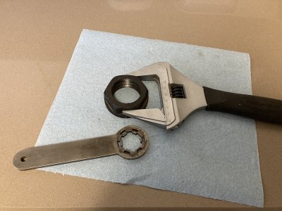

Maybe I'm paranoid but I just watched the last few Vintage Machinery videos where Keith Rucker nearly stripped a massive nut by trying to go the wrong direction. He then had to drill out the threaded shaft because he'd forced the taper so tight that it refused to be pressed. I can't afford that kind of mistake!

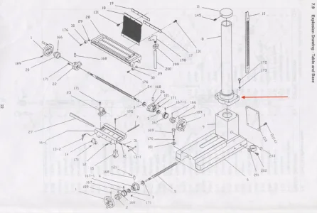

Mine may be a little different. I'm trying to separate the head and column where it bolts to the base casting at the line shown below:
Otherwise, I think it is too much weight for my son and I (well OK, me mainly) to get down the basement stairs.
I can picture a chain going down the column...but what did you secure it to in order to lift the head?

Well Ya, don't get silly with it. You're going to find that keeping the spindle from rotating while you torque the nut is a challenge as well. I think I used a crescent wrench on the spindle plines as it torqued the nut loose with the pipe wrench?

That assy is going to be close to 200 lbs.

A couple feet of common 1/2" fine tread ready rod dropped through the center of the spline shaft and a couple flat washers that fit flat to the spindle nose and a couple nuts threaded on the ready rod to keep it from pulling back through and then a chain/cable eye threaded onto the top end and lift the head free of the column....lightest you can make it I think.
Then do the chain dropped down through the column trick Craig mentioned (all you need is to hook the chain hook to the chain creating a small loop, now just run a rod through the loop so it catches across the tube opening) to move the base and column as a single piece ( you don't have to remove the column & chance changing the "plumb" of the machine).
I have moved my entire mill without removing the head, using the chain drop down the column trick for at least 4 moves.
So you recommend...what?
I have done the chain trick on my mill/drill which is massive by comparison. Just put an eye ring on the end of the chain, drop it down the column and then slip a bar through the eye. Then I lifted my entire mill/drill with my overhead. Worked just fine.
A smaller subset should work for you too.

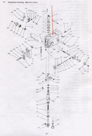

My plan for lifting was to pass the strap down through the head casting at the point shown with the arrow below, around a chunk of 2X4 and back up.
Very easy to secure, pretty close to balanced, and I could either lift the head free of the column or remove both the column and head from the base this way. Sparber's write-up estimates the head at 110, the column at 85 and the base at 100 pounds. I was planning to strap the head and column to a 2-wheel cart as the head by itself is the most awkward piece to hold onto. Strapped securely to the cart, I think my son and I could get it down the stairs safely. Two guys, one step at a time.
Re column alignment, I haven't mentioned before but 'Bubba' stripped one of the 4 bolts securing the column to the base casting. The previous owner welded up a bracket for the DRO display and used 2 of these bolts to attach it to the machine. I presume he was the one to strip the threads in the casting. I'm planning to buy a 7/16 helicoil to patch it up. Going to a bigger bolt size won't work as there is no room for a bigger bolt head.

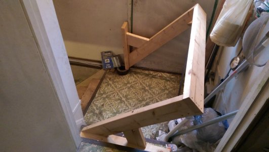

To a point... we just about lost it moving my 400 lb shaper down the stairs.
That’s why I made this it fits in the doorway (when it’s open) supported by both ends in the door jams and the winch hooks in the middle. When in use there is a plywood base (full length) almost as wide as the stairs this sits on the landing and extends over the stairs (3 1/2‘, 4’) that is supported by a 2x6 box keeping it level. To use it first the plywood is put in place that gives you about 4’ overhang over the stairs supported by the 2x6 box to keep it level now the machine can be rolled in place onto the landing when it is in place the frame is put in position and hooked up to the winch then remove the 2x6 box and it can be tipped to slide down the stairs. We used straps so it wouldn’t just slide on the plywood.
The right wrenches make all the difference. Got the nut off with no problem...Bubba left this one alone! Is IS a left-handed thread, though. Here is what I used:
I have a user-made spindle wrench that came with a box lot of milling cutters and whatnot some time ago. Totally paid for itself today.
After that, all it took was a little bit more than hand torque with the gear puller to pop the pulley off the top of spindle.

I have several of those adjustable wrenches from small to large. I LOVE them. They stay nice and square and adjust easily too. The small nose even acts a bit like a socket at times. GREAT choice!
