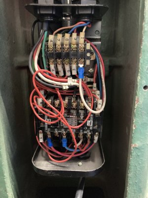

The only thing I've done to this mill since it arrived was to clean it and get all the 110 volt stuff working , I added a quad outlet box , so the DRO , the power feed and a work light can be plugged in , with room for one more item to be plugged in . There was a coolant pump but it is fubared and was a victim of being put away wet , the reservoir that once held the coolant is missing but the ruined pump was still there . Maybe down the road I will replace it and that will be the fourth thing that gets plugged in to the receptacle box.
The receptacle box has it's own cord and plugs into a standard wall outlet.
Just to review .............. it has a three phase motor , I believe it came this way .

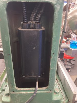

The 208 / 24 volt transformer ? , at this point I'm not sure about that , it sure looks like it was added on at some point .
The transformer is inside a box that is mounted externally , on a removable cover that is screwed to the back of the column . Inside the column , when you remove the cover there looks to be a large capacitor ? , I'm not sure , I'll get some pictures of that when I get a chance .
At this point , it's a mystery machine ............... I should make up a wiring diagram of the way it is configured right now ................... I've been staying busy with other stuff .
I'm the second owner , it came from House of Tools 1994 ish ..........
The transformer ..........
The motor
Yesterday I pulled my blast cabinet out of the way so I could get at the back of the mill and peek inside the cover on the back of the column .
Now I know what the 208v - 24v transformer is for .
This is the cable that supplied the machine in it's former location .

I'm not convinced that is what I want , leaning more towards leaving the controls and wiring in the machine original , not rewiring the machine , avoiding complexity and additional controls .

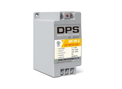

I will mention this again because no one has responded to post # 4 , where I posted a picture of a digital phase convertor , similar to this one ..........
Thoughts ????? on this device
I'm asking because after looking through and reading reviews on Amazon , there are some pissed off customers and a few that are happy .

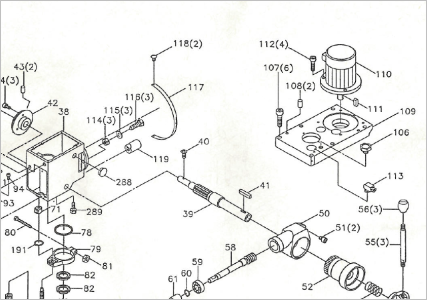

close enough flange dimensions, but there were some variations to the shaft length/diameter/key
This is why I made my own adapter to go from the 145TC ( 56c is an option too ) to that metric shit on the RF45.
I also bought a larger shaft motor ( 145 TC ) and opted for the 3600 rpm version, Turned the shaft down and milled a new key way ( diameter is metric and keyway is metric ). Attached it to my 3d printed adapter ( PETG ) and bobs your uncle!
None of that silly metric motor garbage.

@Proxule I assume you pulled the rotor/shaft assembly & turned the shaft down in the lathe? How much effort removing & dealing with bearings & such?
I assume 145TC is an IMP spec, so an IMP shaft which you turned down to Xmm diameter the RF45 needed? And the adapter plate was needed to marry the IMP bolt pattern to (assume) metric RF45 bolt pattern?
Was your RF45 motor kaput or you wanted to replace/upgrade for other reasons? I recall the stock spindle speed was ~1800 RPM but I can't recall if that was the 1:1 to motor spec or reduced. Are you saying 3600 RPM you doubled the speed?
