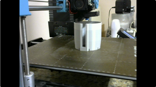

But given the expense of this support stuff why not use regular PLA or PETG and only use the special support filament for the boundary area. Such a cool idea.
One thing I don't understand is why the support filament bubbled up (or gobbed) in a couple of places. Those bumps were reflected in the layers laid on top of it.
Here it looks like the PLA under where the support will go has perhaps also a bit of a glitch.
What is happening here are small bits of filament that drop off and add to the surface. On the P1S (X1 too) you should enable the Prime Tower. Now if you don't have an AMS, then after enabling Prime Tower, select with the dropdown, Timelapse - SMOOTH. This will force the tower and remove most of those zits too.

You can also try tree supports, which sometimes solve problems. The 'on build plate only' option is worth looking at depending upon the design.
When changing filaments, you can flush into infill to save filament and time. Don't do this with support filament. Saved many hours on a complex multicolor print with this setting.
