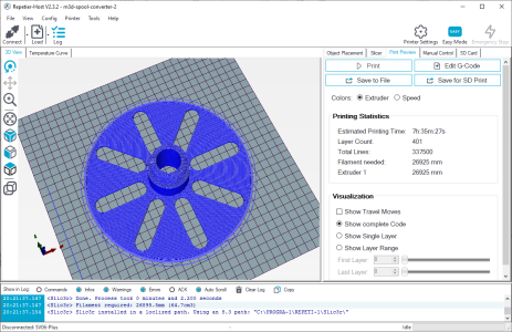

Just to get back to transferring via internet. I've been doing drag and drop on the old printer for 8 years. No Sneakernet. No mucking around with the front panel to chose what file to print. Instead a Raspberry Pi2 in fact for the old system with a Pi Camera and OctoPi instead of Raspberry Pi. It runs software on the browser called OctoPrint. The Pi attaches to the port you would use if you were using the older RepetierHost to connect to the printer.

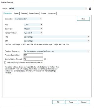

For example: With your PC, after slicing you can look at what will be printed. Now you have the choice to print to a file. Or if you have your printer connected via USB cable
Set say as COM1:
If it talks you can then click on print and away you go. User interface but no camera unless your PC has one connected to it's USB port.

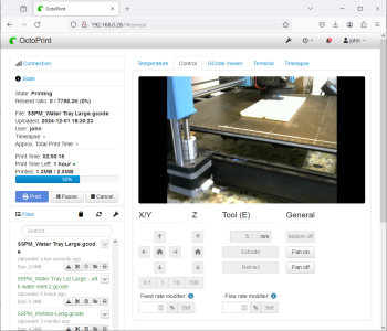

Alternatively you connect that Raspberry (Pi4 nowadays) to the printer USB port and connect to it via WiFi or an Ethernet cable.
The above screen is from the browser to ip address 192.168.0.28 Sign into the Pi Octoprint program and then drag and drop your file onto the file list. Tell it to print and watch it do what it does with the Pi Camera.
Yes. I've simplified the installation. But there are tutorials out there on how to do all this. The point is that Klipper using say ORCA looks way more like my new Bambu user interface. New tings to learn.
But no sneaker net.
