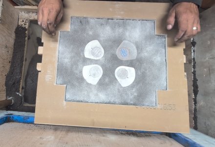

These 3 new castings plus the original pattern will be molded up together in an oversized flask, and from that I'll cast an aluminum matchplate pattern sized to fit my 12x12" flasks. I thought I had a flask more than big enough, but it turns out my biggest is longer than I need but a little bit too narrow. I'll have to build a new one that I can use to cast the matchplate. And any other matchplates I might need for my 12x12's...
Then I'll be able to make up a mold and cast 4 pieces at a time really fast and easy, since much of the hand work that goes into making these molds will already be locked in place on the matchplate. With 4 per mold I'll be able to make ie. a dozen dice dungeons (3 molds, for the sake of comparison) in perhaps half to 3/4 of the time it took me to ram up and pour the 3 smaller individual molds these new castings came from.

After a nice week off spent out west with my parents in West Kelowna BC, I'm back home and able to get back to work.
Next step: Build a new flask big enough to mold and cast the aluminum matchplate fitting my 12x12" flasks. And a bottom board for it.
It is big enough that I should probably add a crossbar to the cope, to prevent it from spreading if the long sides try to flex outward. The drag could get one also, I suppose. I also need to add some sand retention recesses to the inside face of both flask halves.
I plan to use the method described here to cast the matchplate with 4 pieces on it: 'Super easy durable cast aluminum match plate patterns'.
I haven't cast a matchplate this size before, but smaller ones with max. 2 pieces per mold have come out great, so I don't anticipate trouble. And now that I have this flask that is custom sized for it, making more cast matchplates for my 12x12's won't seem so daunting. Although this will be quite a heavy mold to ram up and manhandle around the shop...

The flask is now finished. Sand retaining features were added to the inside walls of the flask, as well as a crossbar for the cope to help support the wide expanse of rammed sand when the cope is lifted off the drag.
I also measured and cut out the drywall spacer that will form the plate portion of the matchplate pattern. The cutout in the center will fill with aluminum to form the plate between the cope and drag features. Maybe you can see that I've also traced out where the patterns will be located when I ram this mold up.

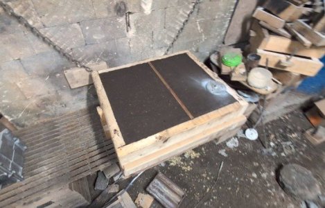

The crossbar in my cope wasn't enough. I needed to make it protrude.deeper into the sand, and/or have more than one of them. The cope began to drop out when had only been lifted maybe 3mm off the drag, I could see the rammed sand cracking on top of the cope. Set the cope back down quickly enough to hopefully save the mold and opted to roll it on its side to open up instead of trusting gravity. It almost worked.
Unfortunately, on a mold this big and heavy the wooden flask alignment pins had enough give in them (usually helpful) that it allowed a slight mismatch/double imprint of the dymo tape labels to occur on the back side. The cracking probably didn't help either. To me that's a deal breaker, especially when casting production patterns. Had to break out the cope to try again soon, but at least the drag is still good. Can't win 'em all...
I'll probably go directly to opening the mold sideways when I try again, because that cope was heavier than I expected. I'm going to need help to get the finished mold in place as well, luckily my wife's uncle is staying with us. But for lifting off the cope at the molding bench it's a bit cramped for 2 people to get in there to pick it up and also keep it level.
Really this one is big enough it ought to have been rammed up on the floor, not the bench. I made my best sand rammer patterns as separate ends to be cast and attached to wooden handles specifically so they could be used to make either bench or floor rammers, but of course I still haven't cast a second set yet to install on a 4' longish handle...

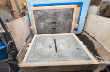

Found time to try again after work today. Wound up losing the drag I thought I'd saved when a pattern fell out and tore a bunch of sand out with it, so I had to redo the whole mold. 🙁
Thank goodness my wife's uncle is staying with us, so I had some help moving this big beast around. Opening the mold sideways worked fine and avoided the risk of the cope dropping out again. (The drag was supported from.below by the molding board.as.I lowered it here after separating the mold halves, so it never had the opportunity to drop out like the first cope tried to do when nonvertical and unsupported)
The runner will be in the center of the 12X12" molds with the sprue at one end when I cast the actual "parts", but for this larger mold to cast the matchplate there is no runner and the sprue is at the far right end of the mold cavity. I've elevated the leftmost end of the mold in position for pouring by somewhere between 1/4" and 1/2" above level, to promote laminar filling of the mold cavity from right to left, as I think I have described before. I always do this when casting wide thin stuff. Probably hard to notice it's not quite level in this picture, but it is. The fire bricks in the background aren't necessarily level either, that wall is actually a temporarily repurposed burnout kiln lid.
Closing up the mold while it was back up on edge again did make keeping the drywall matchplate spacer between the mold halves from moving out of its designated place a little tricky, but I think it ended up close enough to the alignment I intended that it'll all work out ok.
As long as the more than 15x15" of mostly unsupported cope sand currently hanging over the middle part of the drag doesn't fall before I get to pour it that is! Like say if another nightmare red squirrel got into my shed again and happened to scamper across the mold... that might be enough to do it for all know. Hopefully tomorrow I'll have time.to pour it before I have to go pick up my van. If not, it'll have to wait til after my camping trip & hopefully it'll keep for that long because I don't want to ram it up a third time! But with me being away for most of a week, it's.really their perfect opportunity to come for their revenge. The squirrels that is.
I not sure if the #12 crucible I use for aluminum will be sufficient, so I've prepared one of my #16's. Probably I'm just being paranoid, but the 16 is also a better fit for some scrap cast aluminum worn out corn harvester parts I got a bunch of from the tractor repair shop down the road, which I am very happy about. Melting them whole will.be awesome, I'm not used to not having to chop up the scrap cast aluminum I melt. Normally in the past I've used car.wheels.for 90% of my aluminum casting stock, and they require significant processing to fit.
