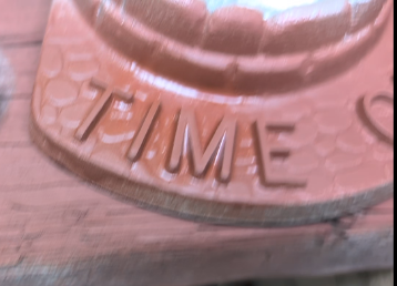

Let's see.... Ok, I guess the most interesting part of the pattern making process so far here that isn't 100% self evident was using a 1/4" spacer between the rows of "bricks" while using my disc and spindle sanders to put pattern draft on the outside/inside of both rows at the same time. Removing the spacer layer after sanding this taper made the bottom of the top course narrower than the top of the bottom course, creating a small shoulder that gives the appearance of the separation between brick layers, but without creating any undercuts.
I made sure not to round off the top of the lower course or file the spaces between individual bricks farther in than the depth of that shoulder, as that would also create undercuts.
The plastic cobblestone texture is a piece I cut off a roll we picked up in Michaels' Christmas village decoration aisle a few years ago. Plus, in no particular order, there's also wood, plastic sign board letters, and a few ground down plastic polyhedra.
To build the pattern so far I've used dividers, a straight edge, pencil, sharpie, scroll saw, band saw, oscillating spindle sander, disc sander, white glue for wood on wood, CA glue for the plastics, spot/glazing putty, sandpaper, and files. I think I remembered everything. Oh and clamps! Of course, a bunch of spring clamps for gluing up.
Other than that there's not much to say about this one. At least not yet. It's a fairly simple flat back pattern. There is actually a recess on the bottom I suppose. But it should still mold up exactly the same as any flat back pattern, so that's what I consider it to be.

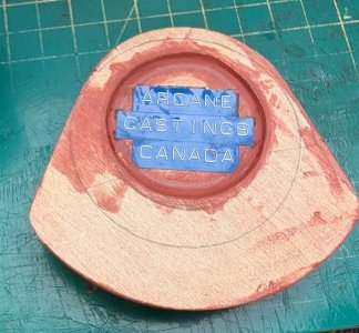

I do need a project to learn how to inset copies of recessed pattern details (like the back of this pattern where the dymo tape is stuck) into a matchplate board, old timey patternmaker style. Like this matchplate seen on Roscoe Pattern Works' YouTube:

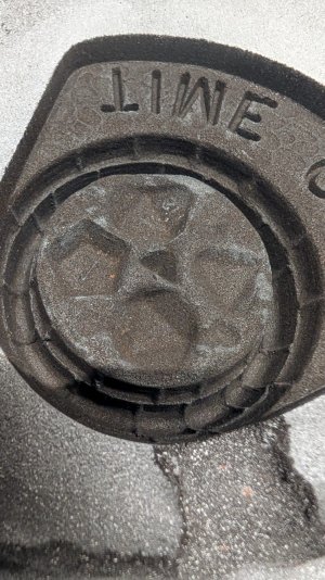

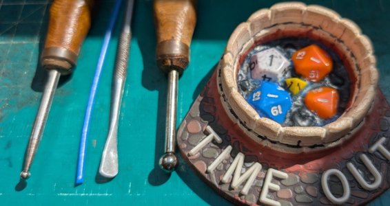

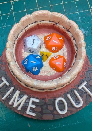

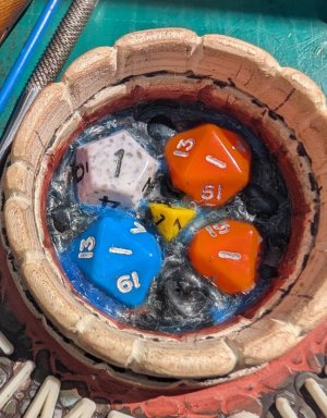

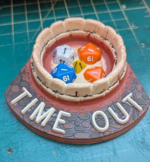

Bubbling lava. Or acid. Whatever sort of dangerous and probably foul-smelling dice-melting liquid it is depends entirely on the paint job someone gives the casting.
I have no training and hardly any experience in sculpting, so it doesn't look as good this close up as I hoped, but in hand IRL where you can't zoom in on the ~2" pit of doom, I think it'll work ok. And I know I'm at the point of diminishing returns where putting in more time refining it won't improve things enough to be worthwhile. If the dice more or less look like they're melting into a frothing pool of doom, I'm satisfied.
It was fun playing with hot steel balls and wax for a while, but the stuff is a little frustrating to get used to pushing around, then before you know it the ball cools off a bit too much and you do something rough looking that you have then go back and fix. Arrgh. The guys who do lost wax casting by sculpting the wax patterns directly... boggles my mind.
I don't expect the wax to hold up for a ton of molds, experience using it for making fillets on patterns tells me it's a little soft, and ramming the sand into it will take a toll. But it ought to last long enough to cast a few copies to use as patterns.
I thought about sculpting the lava in (friendlier) polymer clay instead, onto a lava-free casting. Then I could stick the whole pattern in the toaster oven to harden the Sculpy without burning the original wood and plastic pattern, and cast my permanent patterns from that. But using the wax will work, and this way the final castings will just be copies of copies, not copies of copies of copies.

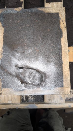

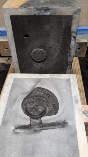

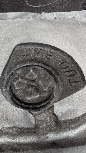

Got 2 rammed up this afternoon before I had to leave to pick up my daughter. Took a few pictures as I went...
Positioning pattern in drag side of the smallest flask that still leaves room for a runner and in-gate:
Gratuitous pouring basin:
(Mostly) Finished mold:
Just needed the sharp corners at sprue base and end of in-gate radiused off a bit here.

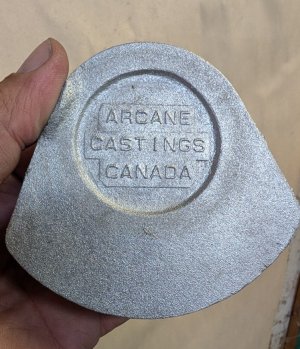

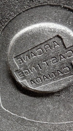

Close-up of Dymo tape label impression:
I very much want to try (again) to cast individual bondo pattern letters using embossed dymo tape as a mold sometime. My first attempt failed miserably, but I've gotten some good tips since then from a fellow who did manage it once...

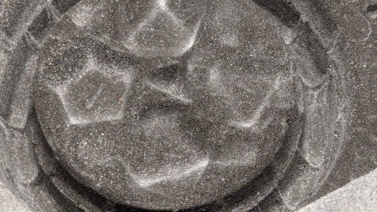

Close-ups of dice and lava impressions:
Added a bit of parting; makes it easier to see the details. The 1's on the dice are just barely visible. I hope they cast out well...
Additional details of cobblestones, text etc.:

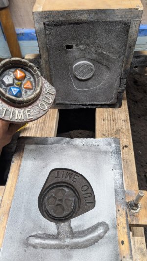

Mold #2 rammed up:
If I could, I'd wait to pour these until I have my 4 pattern copies rammed up.
If I could, I'd also make one extra mold and pour a copy of the "home sweet dungeon" plaque in Al too while I'm at it, to keep for a pattern. So as to free up its cast background and my plastic pattern letters for other jobs. Because this was always the plan for that pattern, those letters were just white glued on, for easy soaking back off of the aluminum background.

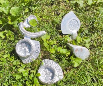

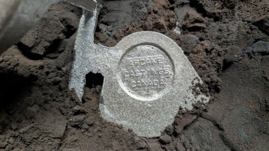

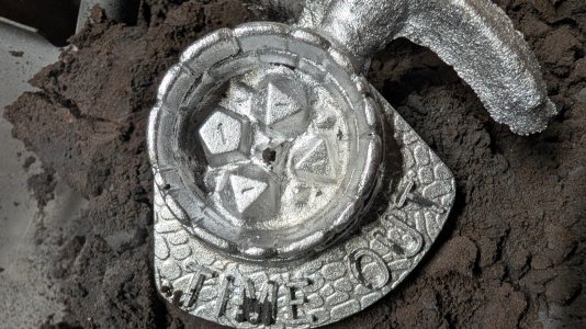

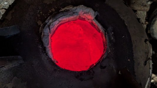

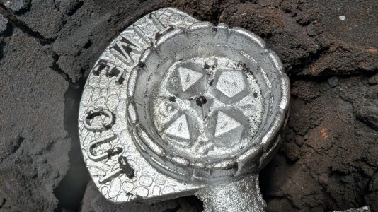

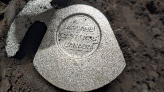

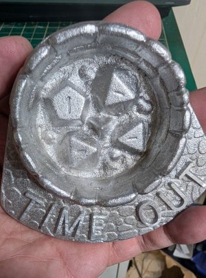

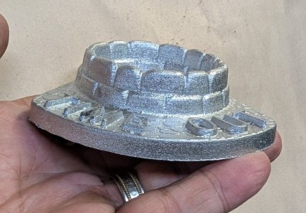

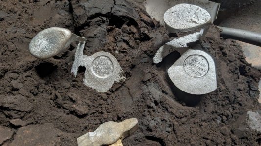

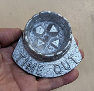

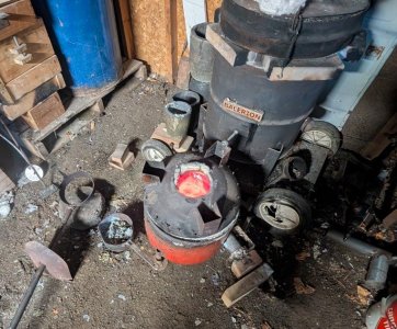

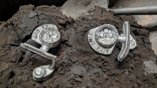

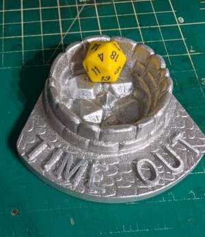

I poured just the two I had already molded.
Woohoo! Happy to see all the details came through.
Just have to brush off the sand, cut off and grind down the in-gate on one of them, and it'll be ready for the game table on Friday.night. Unpainted. I don't have the eyes for that anymore.
Jeff

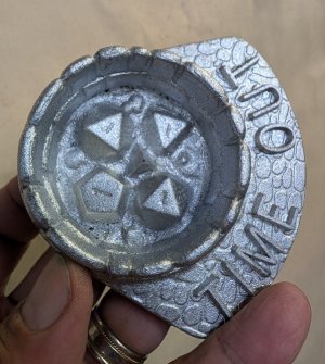

I should have gated into the flat back that gets sanded smooth anyway. Gating in from the side required more grinding off of sand cast texture than I want to live with...

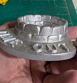

So the first 2 probably won't actually be useful as patterns. But I did get one playtest-ready for tonight's game session...

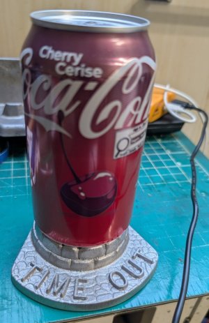

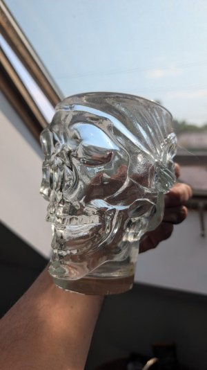

Cool idea. Maybe a little too small, but hey the inside doesn't need a flat bottom if I use it as a can coaster. It kinda looks like it wants someone to knock it over though.
I don't think my D&D night mug is gonna fit... 🙁
Along similar lines, I always thought my "bug out" castings could keep wasps out of a beer just as well as they keep spiders out of a sprue. 🙂

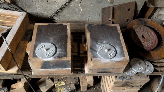

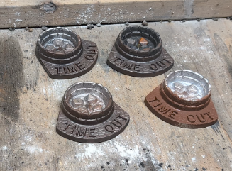

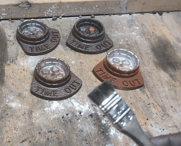

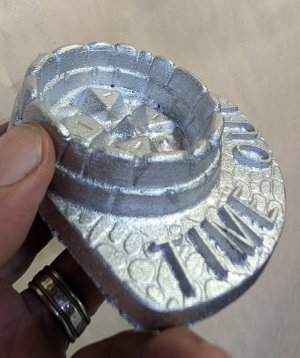

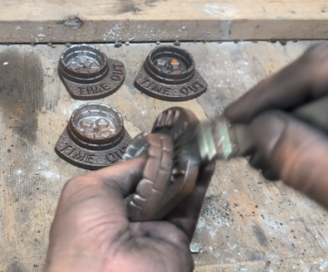

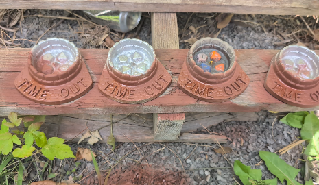

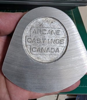

Got 3 more copies cast. Poured them a little hotter than I needed to so there's a little more sand texture showing than they had to have. But with a little touching up they'll make decent patterns. Gating on the flat back this time for easy cleanup, I'll just have to remove a tiny bit of flashing and sand the flat back smooth after cutting the gate off - everything visible when It's sitting on the tabletop will retain the as-cast texture.
Most of the steps in the molding and casting process are shown here, plus a little about about how I made the pattern.

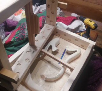

These 3 new castings plus the original pattern will be molded up together in an oversized flask, and from that I'll cast an aluminum matchplate pattern sized to fit my 12x12" flasks. I thought I had a flask more than big enough, but it turns out my biggest is longer than I need but a little bit too narrow. I'll have to build a new one that I can use to cast the matchplate. And any other matchplates I might need for my 12x12's...
Then I'll be able to make up a mold and cast 4 pieces at a time really fast and easy, since much of the hand work that goes into making these molds will already be locked in place on the matchplate. With 4 per mold I'll be able to make ie. a dozen dice dungeons (3 molds, for the sake of comparison) in perhaps half to 3/4 of the time it took me to ram up and pour the 3 smaller individual molds these new castings came from.

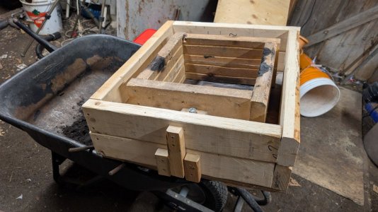

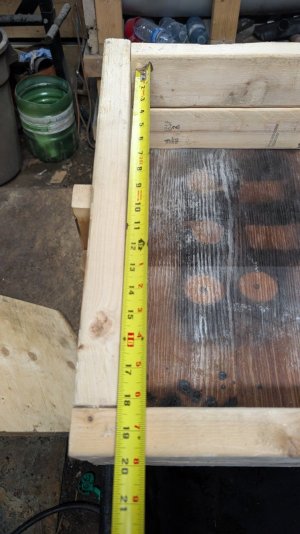

After a nice week off spent out west with my parents in West Kelowna BC, I'm back home and able to get back to work.

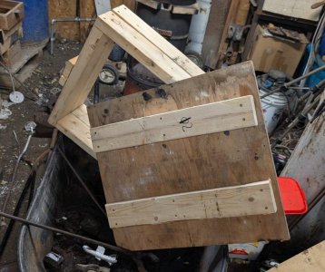

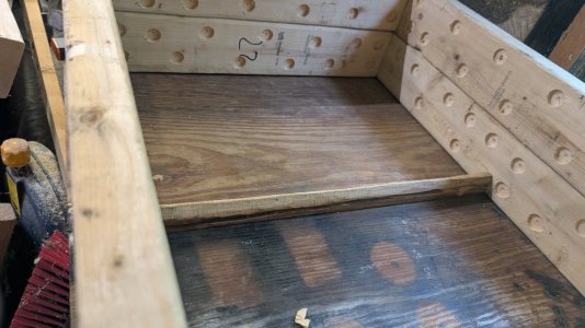

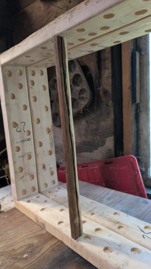

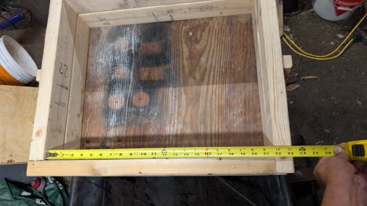

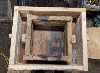

Next step: Build a new flask big enough to mold and cast the aluminum matchplate fitting my 12x12" flasks. And a bottom board for it.
It is big enough that I should probably add a crossbar to the cope, to prevent it from spreading if the long sides try to flex outward. The drag could get one also, I suppose. I also need to add some sand retention recesses to the inside face of both flask halves.
I plan to use the method described here to cast the matchplate with 4 pieces on it: 'Super easy durable cast aluminum match plate patterns'.
I haven't cast a matchplate this size before, but smaller ones with max. 2 pieces per mold have come out great, so I don't anticipate trouble. And now that I have this flask that is custom sized for it, making more cast matchplates for my 12x12's won't seem so daunting. Although this will be quite a heavy mold to ram up and manhandle around the shop...

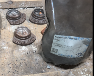

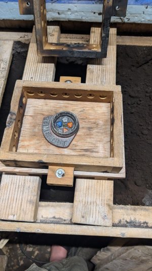

That "Time Out" piece...is that for @Chicken lights?
Btw, very nice work!

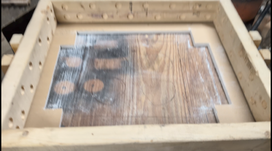

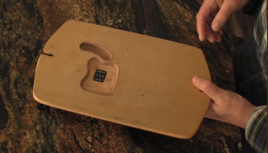

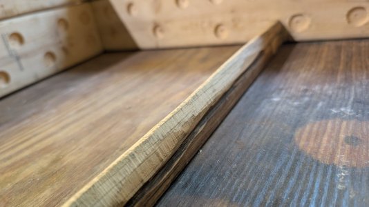

The flask is now finished. Sand retaining features were added to the inside walls of the flask, as well as a crossbar for the cope to help support the wide expanse of rammed sand when the cope is lifted off the drag.
I also measured and cut out the drywall spacer that will form the plate portion of the matchplate pattern. The cutout in the center will fill with aluminum to form the plate between the cope and drag features. Maybe you can see that I've also traced out where the patterns will be located when I ram this mold up.

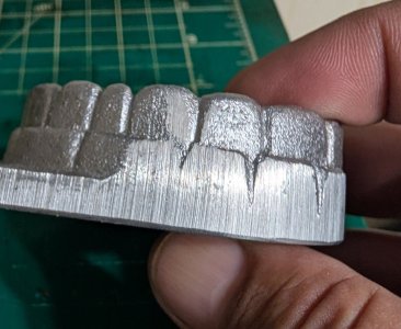

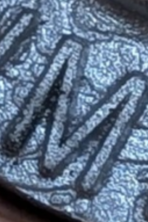

I've never been 100% happy with the M's from my smallest pattern letter font (which were actually meant to be sign board letters). The inside corners under the peaks of the M are too thin and sharp to cast as well as I'd like. They come out a little rough looking for my taste.
So, I've been trying to soften those deep narrow sharp corners with some 2X build spray paint. The tricky part is to not fill in all the cobblestone texture while I'm at it. I think it should help, but I may have to repeat this on the cast matchplate too. We'll see.

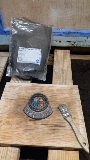

Next step once fully dry is to give them a good scrub with a coarse haired paintbrush that I gave a very short haircut, loaded with graphite powder. This covers the pattern in a thin film of graphite, the scrubbing acts sort of like colouring it all in with a pencil, and makes for extra easy de-molding). Then I can start ramming up the big mold. Not sure when I'll find time for that, but hopefully this week...

A good scrub in graphite powder using a bristle brush cut short leaves a slick silvery sheen on the patterns that will last several uses, making the patterns easier to draw from the sand mold.
