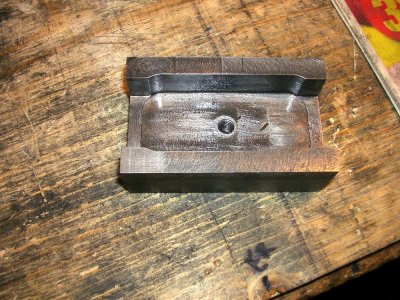

Finished my TA shoe today.... But not without a major ooops.
As I was attempting to mill that sidewall recess the whole work piece pulled out of the vise. Made quite a mess of things. You can still see a remnant of the damage on the bottom face. It actually stalled the 2HP mill and I'm kind of surprised it stalled and didn't break the end mill. I may have damaged my ER20 collet and holder though:mad:. I was so PO'd I didn't bother taking a pic of the carnage. I did manage to salvage what I was left with and achieved the shoe to slide bar tolerance I was hoping for, so I guess you could call it a success.

Well done Craig, like a man who sticks with a project right to the end regardless of unexpected mishaps out of the blue.
...the whole work piece pulled out of the vise
Do you recall the conditions leading up to the event? For example:
- climb milling direction or conventional direction?
- was the bottom of the end mill in contact with the floor the same time it was cutting on the EM side?
- did you feed downward in the vertical direction by some amount, or feed inward into the part?
- what kind of depth of cut?
- milling on the fixed or movable jaw side?
YYCHM
(Craig)
Do you recall the conditions leading up to the event? For example:?
Climb milling into the fixed jaw of the vise.
Yes, and taking a shallow depth of cut on the floor at the same time as EM side.
The spindle was locked and I was traversing the side EM cut.
Too much obviously LOL. This I can't answer.
Pushing the EM into the fixed jaw. If I understand the question.
I think the fact that I hadn't locked the y-axis as I was traversing the x-axis was a contributing factor?
The less rigidity of your mill / vise / table ways / part grip....the more I think its advisable to avoid climb milling for bulk of material removal. Save that for the finishing pass (assuming its required). I'd say this applies to a lot of hobby machines. If the teeth can't get a proper bite due to deflection or vibration or whatever, the cutter rides up the work & wants to tractor wheel causing even more deflection & the process kind of feeds on itself in a bad way. Also, the larger the EM diameter, the more contact area, the greater the chance of snatching all things equal. And yes, locking the non moving way, in this case the Y-axis, would be very advisable to help eliminate drifting table and improves finish. Aluminum would probably be even worse.
An alternative strategy might be
- lock the Y
- start on one end, feed down some safe increment, traverse to the other end of slot in conventional milling direction
- back up under power. It is technically climb milling but no real chip load. But you can safely also observe any finishing improvement as feedback
- if the cut went nicely, increment the DOC a bit more & repeat. Or just take your time & repeat if you aren't sure.
- take the finishing pass with say 1-5 thou DOC to remove the Y depth marks. This DOC is hard to judge because every situation is different but again you can increment in & see how it goes.
- now the side is done, that just leaves the over-feed on the floor. This is where I've gotten bit before but reduce the side load to zero is the main culprit. Its really just cutting on the end of the EM. However it can be influenced by the corner type & condition of your EM.
- check that cutter & material isn't getting too hot at any given time because now you introduce thermal expansion
- CI can be fun because its smaller chips (powder sometimes) so clean out the path often with a brush or vacuum. Rogue chips can hang around & trip up your EM even if everything else is going good.

What was your depth of cut? I hade a total of 0.040” or. 1 mm - just about a 25.4 mm length (1 inch)
If you're asking what the side wall recess ended up being it's 0.08" deep, 1.6" long and the shoe is 2.9" long overall.
But..... that wasn't my intent. That's what I ended up with after recovering from my oooops.
A 0.005" DOC when working the recess to lateral depth was about all I could manage without inducing a lot of vibration. Didn't seem to matter if I was up or down milling.
