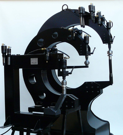

So I have two Ideas for you.
#1 How about spot welding? With a thin backing plate to join the parts together?
#2 I watched a welder working on exhaust pipes (youtube) using MIG and a timer to shut off after 0.5s. The welding machine had this function. I don't have that on my welder but I successfully did it on exhaust pipe with just brief pulses on the trigger. Pulse, move a bit, pulse, move a bit. Slow and steady. Maybe try that on test material and see if you get good welds, adjust to suit. ???
One other point - it's an exhaust not an intake - if it sugars is that actually a problem? If anything falls off then it just rolls out? no harm? or are there other issues?
e.g. https://www.princessauto.com/en/240v-spot-welder/product/PA0008784720
images
