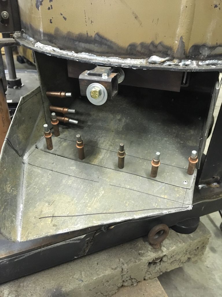

I was making a exhaust shroud for my sand muller today and pulled out my set of Cleco pins. Very handy. Basically lets you drill/align two pieces of metal before you rivet/attach them together.
See video here: Youtube - video on Cleco

Cleco at work
Pinning together exhaust shoot
