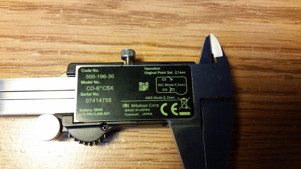

-the label on the back of the head says "Serlal No instead of "Serial No"
-The label on the back says "U.S. PAt" instead of "U.S Pat."

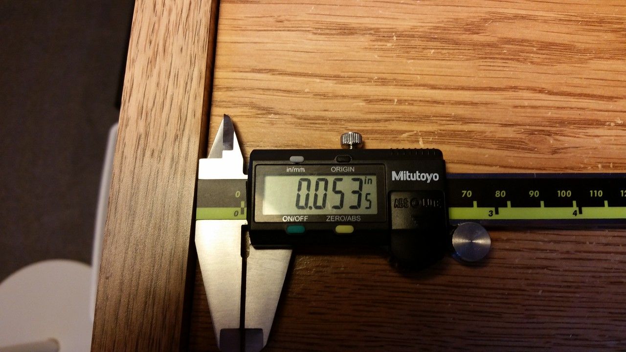

-the least significant digit is half the size of the others where it the same size as the others on a genuine one.

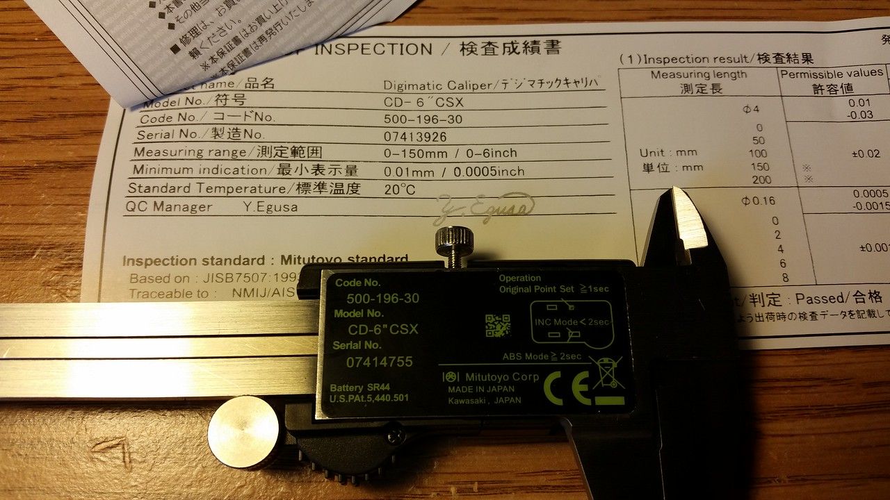

-the serial number on the caliper is different than the one on the inspection document.

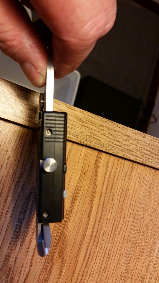

-there is about 1 mm of slop between the jaws like Isak's video shows, the genuine one has no play.

Here you can see
Here you can see

Here you can see
