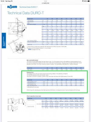

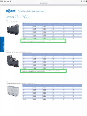

Here is what Röhm has to say about clamping force / grinding / testing / accuracy…

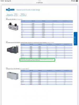

They do not pre grind anything. All jaws are ground insitu at a given torque. That is where the accuracy needs to be measured / is achieved.
I guess with a TPG and careful set-up this can be done in the shop (no need to send in the chuck to the factory for grinding in the new / replacement jaws).
This is the link to their catalogue from which I got the above screen shots.
I will need to check how Bison, or PB, etc do it… my guess is in a similar manner to Röhm.
Thanks! I have never before caught that advice from a manufacturer in their hardened secondary jaws page. This may be due to Rohm's greater accuracy specs. A lot of chucks are much lower accuracy - .006 concentricity for a 1" test bar, for instance.
Pratt Burnerd America doesn't mention this in their replacement "top jaws" brochure:
Pratt Burnerd, like the offshore Asian chuck manufacturers only give a 'repeatability for the same part' specification these days. A less meaningful number that looks good.
Wow. I've never seen a specification like that. But it makes a LOT of sense. Specifying a 10NM (7.4ftlb) Torque on the drives also adds a new dimension I've always wondered about. Presumably the 40 (30ftlb) is max and 10 is for specification.
I'd love to see something similar on the lock cams.
Adds a new dimension to the way I'll think about tightening my chucks in the future.
