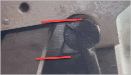

I just received a PM-728 and working on setting it up. I’m fairly new to adjusting tapered gibs setup and I noticed that my X and Y axis move in the range of .0008-.0016” when I lock the axis. I’m assuming this is not normal and my gibs are too loose?
Also my Y axis gib moves up and down across the dovetail when I try to snug it with the thick side adjustment screw (I have a video but not sure how to share it here). I assume this means the gib is not making full contact on the matching dovetail or the taper angle is off and needs to be refitted?

I made a little gif of the gib movement here since I couldn't upload a video, hopefully my interpretation of the issue is correct.
Like I said I have little experience with tapered gibs and certainly with this size of a machine so I just wanted to make sure I have a good starting point for the setup. Thank you all for the great advice so far!

@Eyecon This gibb seems to be "ill fitted". I hope the new one from PM is better. There has to be some up/down play in the gibb or it will drag on the flat-way, scoring it. On my PM935 clone, I think the clearance is minimal. I can check tha once I get it unburied.
With this much clearance the gib can get twisted up (sorta diagonal) making clearances unpredictable.
that's what I figured, I'm hoping there is enough "meat" in the gib that I can blue and scrap it for a better fit until I get the new full length gib blank to refit. I know this won't change the top and bottom clearances but at least if it's properly fit it shouldn't move as far as I understand. The gib on the X axis doesn't do that so as you said, I hope the factory just did a poor job hand fitting this gib vs. some other issue with the casting of the saddle.
the fitment should all be on machines surfaces. Sometimes they make a mistake or 2 when making the gibb, and that is fixable. I really don't think there is a high likelihood of a casting failure or significant dovetail problem.
