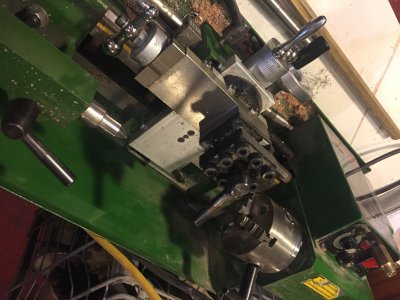

I have a machine similar to yours and there are Set screws for your slides and on the ways that need to be snug enough to allow easy motion but ridged enough not to move ... See the 3 or so holes on the top side of the compound without the tool post? That will help set the screw lash which should be done before attempting to adjust the slides. Basically take the whole compound apart and re assemble it with carefull attention to keeping parts clean and snug. The machine needs to be 100% before the cutting tools should be scrutinized especially in the little machines when you work with steel.
I did clean the machine up and set those screws but looking now at it I think they are not set right, thanks for the thoughts though and will work out the play in the slides.

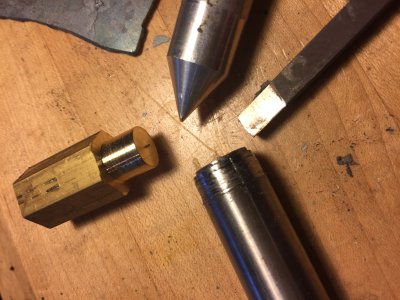

Update on the milling, its going a lot better now with a new set of tools, Carbide tipped tools that is. The mill is clamped now on a sled to my work bench, sliders are adjusted and tight. It finally cuts steel to my tolerance anyway, not perfect but for a hammerhead blacksmith its perfect!
Thanks all for the help

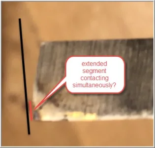

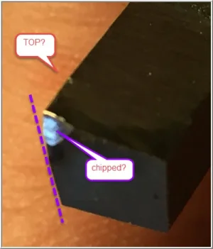

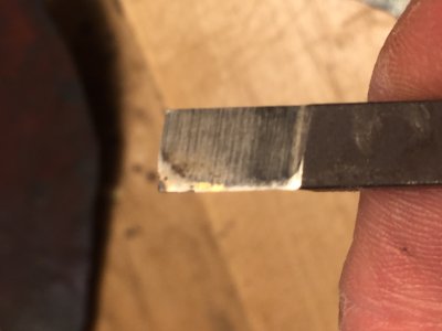

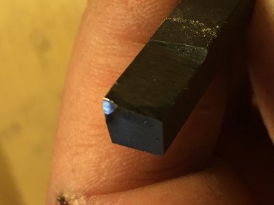

Peter the tool was used for just the brass and the steel, it was brand new when I started. It was very slightly off center and orientated 90 degrees to the work and used right to left into the work piece. I spent a few minutes on the brass and less than a minute in the steel. It dulled immediately and the vibrations set up in the machine was very bad. It chipped when I was machining the steel, no filings were coming off just a fine dust and small chips and the tip burned up right away. Crap tool or more likely my technique orientation etc.? Making a sled out of tube steel so I can clamp to my welding table for use and see if that makes it solid and level as a start. Where is a good place to buy tools?

The wear on the hss looks to me like you are to low on the center line, my tool post is just like yours and I require at least 1 banding shim to get my hss to centre line. Use the pointy center on the tail stock to judge your height. Different cutters do make a difference here but typically you do not want above or below center. with the compound a little on the loose side leading to deflection you will never get it 100% right but that's the trade off from new expensive and new cheap. "The dial in"
I used very similar brazed carbides for a while & still do. Just be aware that some knockoff brands must originate from the same factory that makes other <cough> tools like: crazy carbide boring bars with wickedly off center braze-ons that cannot possibly bore a hole for sh*t. Or crazy 123 blocks with thru-holes that cant pass the same bolt that the adjacent holes are tapped (uh-huh, got some in my own collection). But I digress.

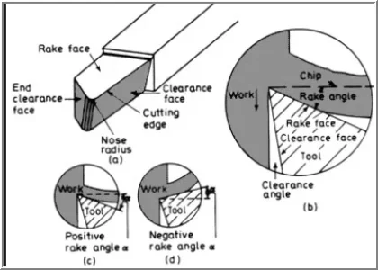

I've seen some of those brazed carbide lathe tools that have no side relief angle or they plopped the carbide on with little or no cutting edge angle. You can re-dress these just like a HSS bit but you need a green wheel in the bench grinder (vs. typical AO) & probably a diamond to touch-up lap (vs. regular oil stone). Carbide is harder than HSS so should hold a cutting edge longer all things equal. And often can be had for same price. But it wont give you a better finish if it isn't shaped properly, may well be INferior for that reason. If its a 'good one' with proper geometry, you are set to go. But just a heads up.
Another lathe tool height centering method if the tailstock is occupied or not convenient: (lightly) squeeze a typical steel 6" rule between the cutting tip against the chucked work. Viewed from the tailstock side looking towards chuck, the ruler should be vertical if tip is on center. Shims may well be required because the carbide shanks can vary in size. Also try to get as many set screws down on the cutter as you can & reduce tool stick-out to minimum to avoid chatter. Good luck!
Thanks Peter, just was using the lathe and am very happy with the results with the fixes I used here. The tools are cutting great so I can only assume that the geometry is in good shape.

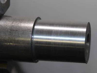

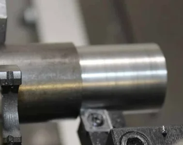

FYI on centre height...
The way to get a very accurate centre height is to turn a cone to a point, using any setup you like (such as a 3 jaw chuck) You then use the point with a magnifier to establish your centre height. You can be +/- .002 for diameters bigger than .750 or so, but for small work (such as .125) it would be better to be closer. For really big work, the tolerance is much larger.
The tail stock is usually pretty good, but can be out more than .002 in many cases. From the factory, mine was .006 high, and I had to correct it.
