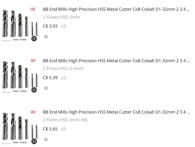

I ordered these through Aliexpress. Arrived today. Good shape in the plastic tube packages. Boy are they sharp. How long they will stay that way...

I tend to break the carbide cutters. These are cobalt so a bit harder than regular HSS. I'll report on them after I try them out. These cost roughly $4.30 each and they are sharper than any of the other HSS I've got.

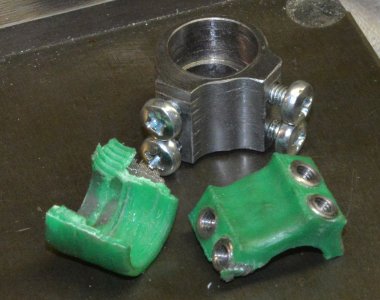

It might also be the horrible backlash in my House of Tools mill that contributes. Although I do have backlash compensation built in with a larger cutter in steel I watched the cutter grab the material and pull the table. One solution is to really tighten up the ways or... a no brainer... get after project #42 and install ball screws.

Try conventional milling instead of climb milling, then you don't have to worry about backlash (in this regard).

Mostly scrap aluminum castings, some aluminum extrusion material (also scrap pieces). Less steel parts but I do steel too. Often I'll try a 3D print first for trying things out. If they break I make them from something else. You can see from the lines on the steel part my depth of cut and the positional issues.
There was a full depth perimeter cleanup pass done.
