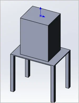

My replacement work tables seem to have escaped construction yet another year unless Santa delivers a TIG, but I was curious about this kind of thing. We intuitively know there should be some perimeter bracing like red lines to box in the legs. And they usually serve secondary duty for shelve support. Your peripheral brace is along the base area, maybe for another purpose? Anyways, it would be interesting to see how the basic frame would look at 1.5, 2.0, 2.5" section. I've seen some nice work tables that look to be basically 'posts' with welded flanges top & bottom. Upper flange screws to table top, lower flange tap for a levelling foot or whatever. So maybe applying some lateral force parallel with table top would also be interesting. Sorry for the tangent, I know you are talking about a machine stand here.

I've been out of school too long. Is there a parameter we that can indicate 'lateral stability'? (example pics skinny stand vs wider stand). CAD easily can spit out center of mass & moment of inertia of machine + stand assembly once we fudge weights. Then what's the next step?
I don't intuitively know that Peter. Other than for long spindly legs that buckle or fold, I doubt such braces do much good at all. Unless there are none at the bottom in which case they do provide a benefit but not as much as bottom braces would.
I think they do the most good at the bottom and provide reduced value as you move them up the structure.
The best isn't lateral braces at all. It's corner to opposite corner braces. Think scaffolding.
I think you are right.
