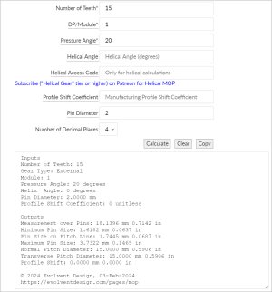

I found this website that calculates tooth depth of spur gears using user defined gage pins diameters making contact between 2 neighbor teeth as per their sketch. Useful for measuring an existing gear, or cutting a new gear because you could compare the actual distance vs the theoretical distance. But what about odd tooth gears where the valleys will not align vertically like the reference sketch? Unless I missed it, the website doesn't even mention this. Unless they factor the odd tooth into the calculation & its still a pin to pin measurement (which seems odd & very undefined).

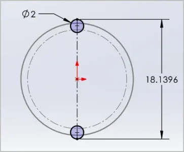

Assuming them mean theoretical vertical distance I made a mod-1, 15T gear, 20-deg PA to see if I could fake it. I transposed the resulting vertical distance of 18.1396 mm over 2 mm diameter pins, but then assume 2 pins within the bottom 2 teeth valleys 360 deg / 15T =24 deg apart, but at the same radius in order to still measure vertically at their outer tangents. Surely there must be a better way. Does anyone have experience with this? Is there a formula relationship to OD & PD maybe? Part of what makes this tricky *I think* is if the cutter profile is advancing into the blank X amount, its not like a cutting tool reducing OD by 2X because the cutter has an involute profile and that profile tangency to pin is what is driving the pin to pin measurement

I have measured gears using the two pin method. It always seemed to work out.
I think unless one uses a CMM, the measuring axis of an odd toothed gear will be slightly off of the normal axis (as seen in your model and the following explanation). The measurement M compensates for that and it seems an accepted practice.
Peter, I like your CAD model and it clearly shows the issue.
I have not found where that is addressed. I wonder if the error is small enough that it can be “ignored” since gears need to have clearance to mesh with each other properly anyway. As long as the center distances are correct, it will work.
Perhaps another thing to consider: the smaller the Module and the higher the tooth count, the smaller the deviation will be.
Perhaps you can let CAD calculate the difference in your example?

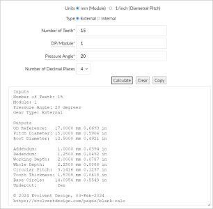

I watched this video from Evolvent Design that deals with measuring gears to determine if they are Module (metric) or Imperial (diametral pitch) (DP). He demonstrates how to measure an odd tooth gear. Since you can't directly measure the OD, instead, measure the distance from the inside of the bore to the tip of a tooth, multiply that dimension by 2 and add that number to the bore dimension.

I also used the catalog pages from Madler as they give the dimensions for every gear. For instance I remember that your lathe has a 30 tooth gear in it's selection of change gears. If your 30 tooth gear has an OD of 40mm it is very likely a Module 1.25 gear as shown on this page form their catalog.
If your 30 tooth gear has an OD of 48mm it is very likely as Module 1.5 gear as seen on this page of the catalog.
I came up with 20 degree pressure angle because I couldn't find any listing for any other angle for Module 1.25 gears.

My 30 tooth has an OD of 1.606 across opposite teeth which is 40.82mm
A lot closer to 1.25 than 1.5. So far so good!
John Conroy
member
Using the info from the video and your dimensions we would calculate DP this way.
(2 + tooth count) / OD in inches or
32/ 1.606" = 19.925
We would calculate Module this way
OD in mm/ (2 + tooth count) or
40.82/32 = 1.275
Then using his chart to display whether it is likely Module or DP it almost looks like it is 20DP and not Module 1.25
