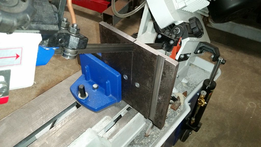

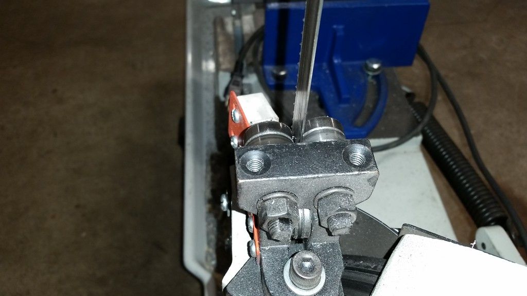

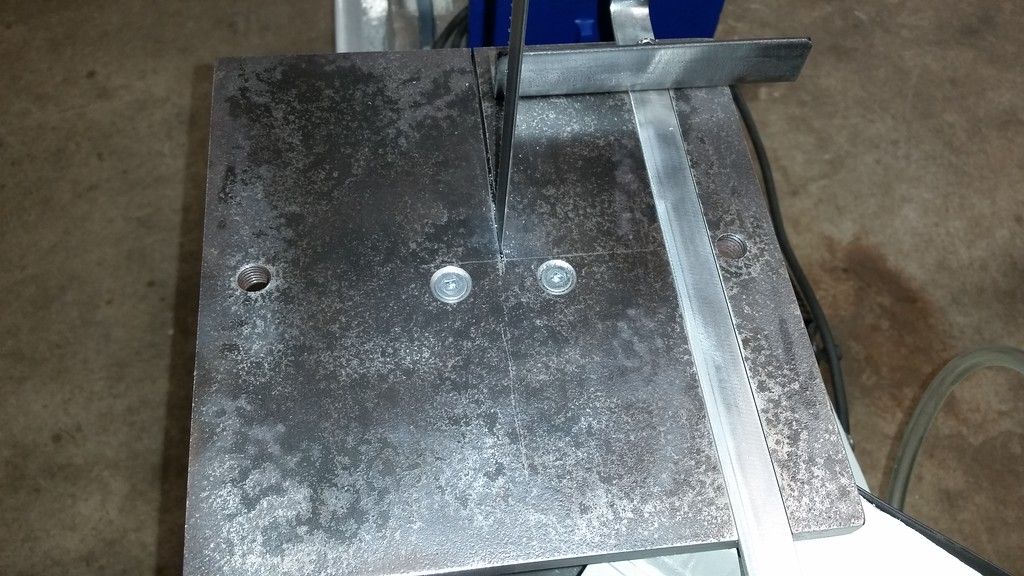

John's saw might be different than mine, but judging by the familiar bolt pattern might be +/- similar to these offshore types. They support the table by a block which accommodates one of the blade bearings sets. You can see the 2 tapped holes on upper surface. The thing I don't care for is its a relatively small surface area to support a big table. Not so much rigidity but alignment. I was already contemplating making a new block but then realized in swing down chop saw mode (with table off) it has to clear the edge of the vise & not bottom out prematurely. That's primarily why its the size that it is. My table is actually pretty rigid for stamped sheet metal, maybe 3mm thickness with 90-deg bent over edges on 2 sides. But it has no real control to ensure it is square to the blade plane as a function of bolt/hole clearance in the 2 screws. A thicker & more rigid table like John's & fence or even a reliable outside edge would be a big improvement. If there was a way to tweak it into alignment or better yet preserve alignment that would be bonus. Maybe if they had alignment dowels & the bolts were just to secure it.

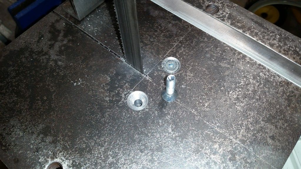

You're right Peter. The bolt holes are 1/4" nc thread so it is actually pretty robust. I used tapered head screws so alignment is the same every time.

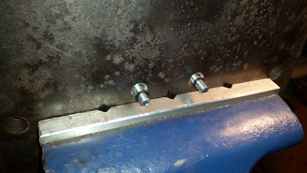

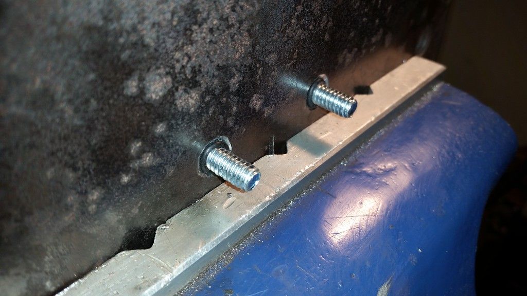

I started by squaring up the plate in the mill. It's a piece that i got from Al in Cochrane when he was getting ready to move. Then i set it upright in the saw and cut the slit for the blade and made the measurements for the blt holes off the slit. The pictures show i set it up and i slit it 1/2 way across.
The picture shows the finished part but this was the first operation after squaring the plate. Since the screws are always going to stay with the plate i countersunk the holes on the bottom and put o-rings over them to keep them from getting lost.

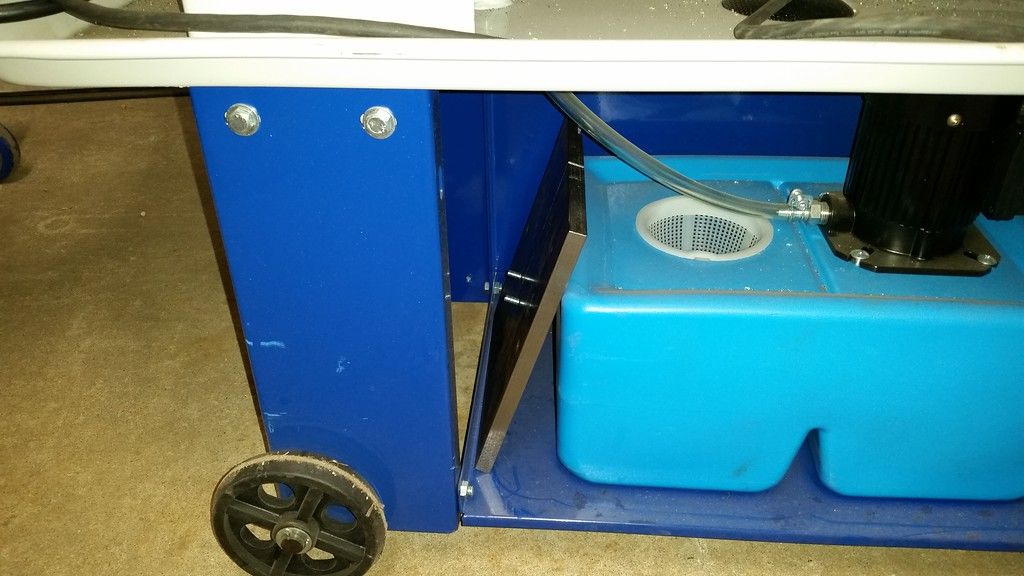

It stores in the bottom of the saw cabinet.
I have one of those fancy Incra mitre gages for my table saw but it is 5/16" thick so i couldnt mill the fence deep enough to use it on a 1/2" thick plate.
