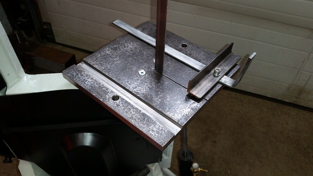

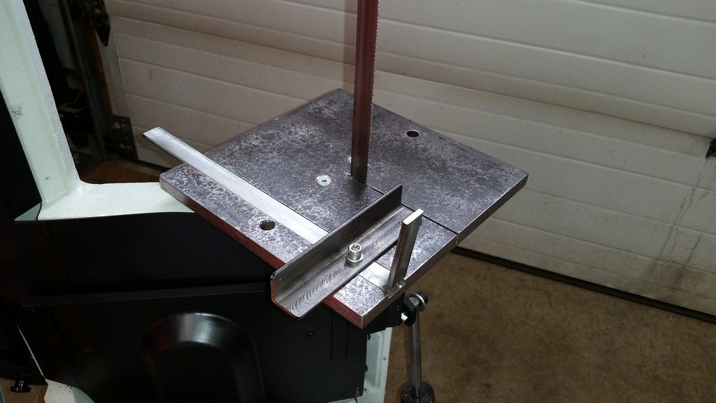

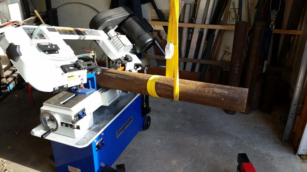

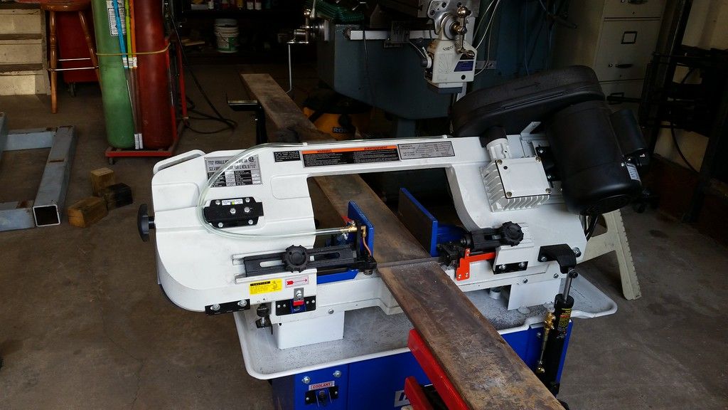

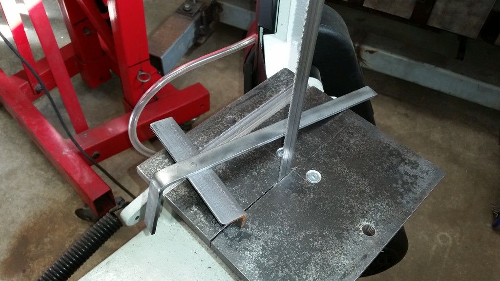

Since the original pictures have been lost in the Photobucket mess im going to post a couple showing the Magnum 7 X 12 saw in action. It is still functioning as new and i use it quite a bit. I added a plate so it can be used as a vertical saw also. One like it is optional from KMS but i made this one from a 8 X 8" plate of 12" steel and milled a groove for mitre gage i made from 3/4" X 3/16" stainless and a piece of 1" angle iron.

Hey John that’s a great mod. The flimsy vertical table that came with my saw attaches to the blade guide. I’m not sure such a beefy plate would work for me but I love the mitre guide. Post another picture of how yours is supported from below?
Incra has a nice mitre guage with precision stops. @CalgaryPT Peter has one. https://m.kmstools.com/incra-5-precision-mitre-gauge-2468
@johnnielsen showed me an article on another approach. You make a folding bench to sit on which is clamped in the saw vise. It then has a vertical table attached with hinges for cutting on. I’ll see what I can find and post.
Edit : here we go- similar to this
https://www.instructables.com/id/Vertical-Bandsaw-Table/
In the other article I was reading they did not use big L shaped supports. Instead it had hinges so the whole thing folded flat when not in use. Easier to store.
