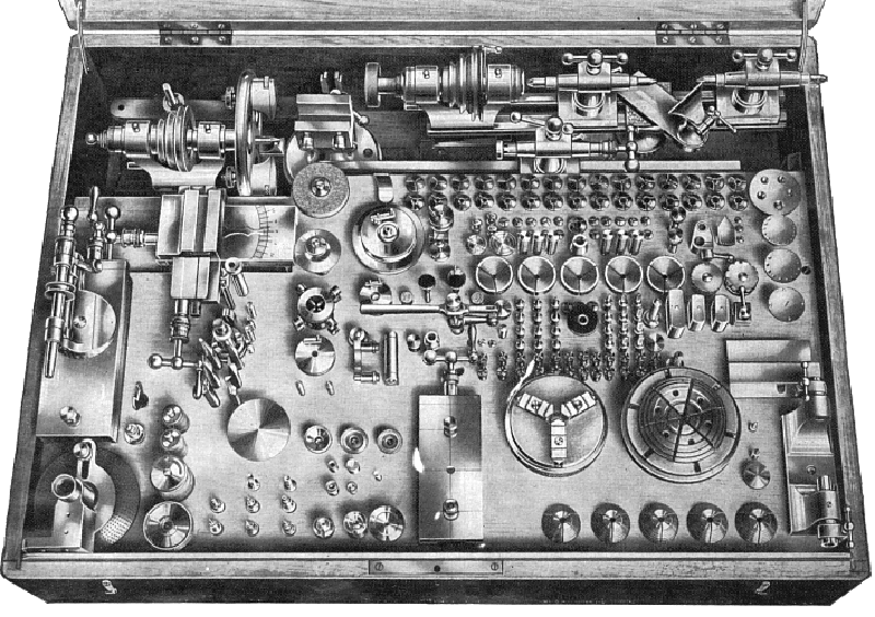

FWIW, a complete set of collets is fifty pieces. sizes 1 through 50.
Yes and no, according to who? I have sets like that (Levin and Schaublin) but also very complete Boley sets that don't have that many. Here for example is a ww83 which is the large boxed offering for one of their top of the line models. i.e. they're weren't holding back on this one. Its complete boxed set as Boley sold it, as best I can tell, but that doesn't there aren't other things in the catalogue not part of the set. It would be nice to have an old Boley catalogue to see exactly what else they offered, never come across one :( . I've also got a boxed Boley Geneva style that has similar complement of collets....none are missing but there aren't 50.
The Levin set is by 0.1mm starting at 0.1 mm. The Boley set starts at 0.5mm, has a few of the smallest sizes with 0.1mm increments, that changes to 0.2 mm. I think Boley knew a thing or two about keeping watchmakers happy and that's how they equipped one of their top of the line packages..... I mean is there practical use for collets below 20 thou? The pivot on a balance staff can be 0.1mm diameter, but you aren't holding the staff by it.

I have a few catalogs from the 1940-1950's time frame, that have Boley stuff in them. And Levin, Marshall, and a bunch more makers.... Was pretty heavy in to watchmaking and clockmaking stuff for a while. The catalogs came from some groups of literature I picked up over the years.
Gonna suggest that the "Kit", like all such kits, has contents tailored to covering as many options as possible, rather than being an all in one, 'Complete' assortment of tooling. Like any such kits, one bought according to means, and need.
