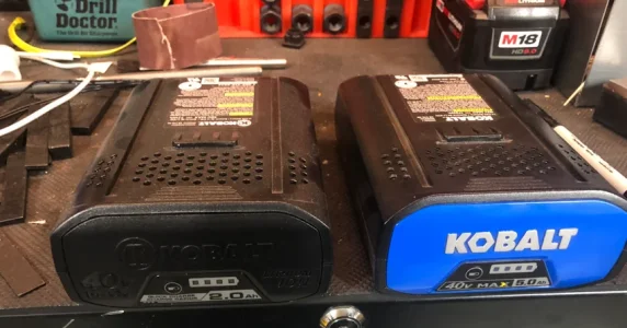

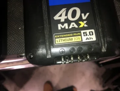

I'm planning ahead WRT batteries as the battery pack to power the mower itself is a 40V 5AH one that you can no longer buy. The mowers seem to last forever but lots of people on the internet says the 5AH packs fail after one year. I do have a 2.5 AH backup pack, but I like being able to mow the lawn without recharging packs. Plus, I want to try my hand at making one. I doubt I would be able to disassemble the existing pack and retrofit it with new cells, so I would just make my own enclosure. My pack has 3 terminals on it and from what I understand the third terminal sends a signal when the pack is too hot, and the mower shuts down. I need to figure this part out at some point. I think the terminal just goes high or low when a fault occurs...but I am just guessing.

Ahh yes, methinks we should pool knowledge at some point. You've got quite a bit more than I do on this topic already. Actually the 5 AH came with the mower (Kobalt). On closer inspection it isn't sealed in fact; there are screws holding it together, so I will take it apart soon to check out the guts. I really want to understand the extra terminals so I can build my own. The pack snaps into the mower and I now see it actually has four, not three pins—so even a bigger challenge to sort these out. But the pack provides voltage for the mower blade only.

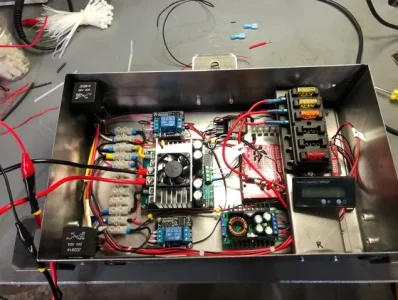

The drive motors (two 24V wheelchair motors) are powered by two 12V 35AH conventional lead acid batteries wired in series. They also power the onboard electronics using a Buck converter to supply a 5VDC bus for the two Arduinos and receiver. The motors are controlled via HD 24V relays, which also control the magnetic brakes on each drive motor via a receiver/relay combination.
There are some onboard electronics to the mower as well, some of which adjust power to the mower blade as needed in tall grass. It took me a while to figure out how to defeat the safety features on the mower as it used a funky mechanical switch in combination with the electronics to start the blade. You have to apply power in a specific, timed, sequence to get it spinning. I had to simulate this electronically.

When I take the pack apart I will report back. It may be as simple as replacing the 3.6V cells inside. There is at least one company online that rebuilds these, so it can't be that hard.
On a fabrication note I was shocked the 16G steel box for the electronics didn't inhibit the receiver like a big old Faraday shield or something. I never range tested it, but did leave a shielded pass through just in case I needed to switch to a receiver with an external antenna. In the end it worked fine for the range needed.

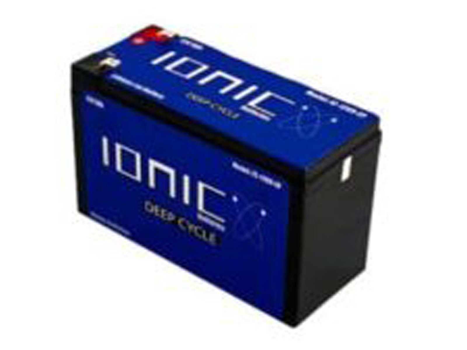

Is 5Ahr enough for you? Reason I ask is there are some deep cycle lithium based batteries for boats/RV etc. I'm going t switch to one next season for my field charge battery, much lower weight, better power density. But I think they start around 10Ahr. But 3x12=36v or 4x12=48V maybe not a suitable match to your 40v nominal depending on your requirements.
