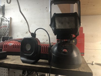

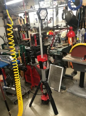

This seems like a simple thread but there can be more to it than lumens, at least for me. I struggled for years with task lighting, going from incandescent trouble lights decades ago to fluorescent, then to LED, but every year I seemed to think, "this isn't good enough." For me the problem wasn't just lumens, but positioning. What I discovered was that no matter how good the lumination, I could never position it the way I wanted. Car repair is a minor issue for me, so a hanging light wasn't as critical as one that could be positioned properly in the shop. Because I do a lot of fabrication, I was always wanting light to shine up from the shop floor to the underside of a steel frame I was welding, for example.
LEDs are a must of course, but I ended up buying a few different Milwaukee versions. The smaller M12's can be pointed almost anywhere, and have the benefit of working as a flashlight as well. They are comfortable to hold and stand upright. The downside is they don't point downwards as much as I would like. But they can be placed on their sides and do come with a hanging hook (can see the black thing projecting from the back of middle light in pic). The next one I use is the six sided M18 one that can be angled or stood on end or hung (but it has no hook). It can be painfully bright, but fortunately has a dimmer setting on it. It's great underneath things, and because of the six sides you can project it along floors, or even downwards. It is a little heavy though, especially with a bigger battery. Lastly I have a tripod M18. It's blindingly powerful (but has three brightness settings). This is the MOAB light that solves all illumination issues because you can position it to be above you and project downwards. The bad thing is it is super pricey. Having said that it has never let me down. It also runs off 110V if needed.
These three approaches solve all my task lighting issues. Once I determined positioning/placement was the real problem and not lumens, I'm never frustrated anymore. I may at some point buy Milwaukee's rechargeable headlamp with strap, but I'll wait for a sale on that one.
That's my two cents worth Peter. Perhaps your needs are different, but my Ah Ha moment related to positioning, not brightness.
P.S. Apologies for the crappy pics. I really do need to go back to decaf.

I think comparing the two could be misleading, as they are designed for different purposes. The M12s in my pic are more work lights—(not as focused as spotlights), but can illuminate a wide circular area pretty well. Trouble lights just seem shower everything in light, resulting in good general lighting but lots of shadows. Trouble lights I find are better compared to floodlights; lots of light scattered over a wide area and tough to focus on a specific area precisely. There are applications where this is what you want, but these are unusual in my case. A worklight such as the M12s in my pic uses much less power (even if you adjust for LED vs incandescent), but because it isn't wasted on the surrounding area it appears dimmer. A quantitative measurement would be a light meter on the nut or bolt you are working on I suppose.
I have two of the M12s in the pic because I like them the most for what I do, but as mentioned your needs may differ. I do give top marks to LEDs and Milwaukee specifically. All the products I have from them so far have been great. I do have an old 100W Trouble light hanging in my shop still. I haven't used it in years, but it reminds me of my dad so I keep it around.
I also purposely glossed over a huge feature because I need to eat some humble pie on this topic—but the portability aspect of all these LED products is bloody amazing. I was no fan of many rechargeable tools until lithium packs came out, but now I feel foolish for damning them (well at least the NiCd ones). It's pretty rare for me to run out of juice these days before I finish a project. Even if I do, they charge really fast. I sure don't miss dragging a 100 foot vinyl cord across the street at -40C to help someone start their car in the middle of the night.
