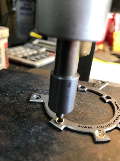

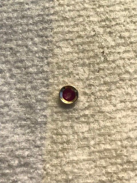

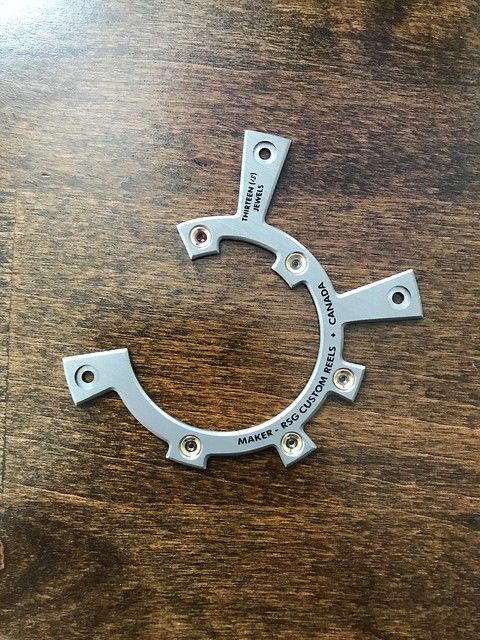

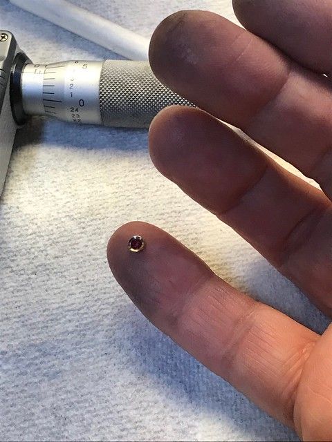

Next came the jewels. Sourcing them in the size I needed wasn't easy but I found a company in Boston the makes custom sized synthetic ruby and sapphire jewels. I machined bezels for them to make it easier to seat them.
I've never thought about machining bezel settings for gemstones. All my silversmithing is soldered, other than flush set stones that sit in a hole grinded with a dimond burr.
