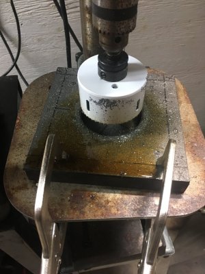

FE355ED9-7D58-49E7-925B-3786E1D7F0F6.jpeg 0857298D-42A3-4E00-9994-FFC69449EF45.jpeg
There’s gotta be a better way to do that. I wanted to have the pipe go through the plate, to weld both sides, for strength.
Which, it fits great, and is perfect!
But the belt on the drill press wants to slip, the hole saw chatters, even with gobs of cutting fluid it was a long slow process to get that far.

Yikes! How thick is that plate you are trying to drill out? How did the original (smaller ID) hole get there?

3/16”? Possibly 1/4”
I started with a piece of 8” square flat plate, used my centre punch then my spotting drill bit, then an 1/8” drill bit. Then whatever size the centre drill is in the hole saw

So in the image you have managed to chew your way through using the hole saw?
Ya, I bet that was tedious.

Ok....so I’m a rookie I’ll admit that.
A friend stopped by the shop tonight. We got talking and I showed him the belt, which didn’t look horrible.
He grabbed the silver handle, moving the motor and pulleys further out, tightened the black knob and said try it now....
I feel silly but I guess you have to learn somehow...
