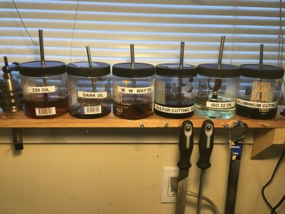

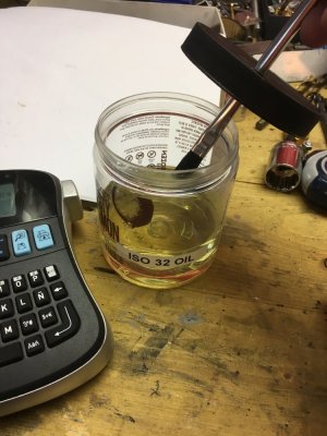

I wanted some brushes attached to lids for various oils and chemicals. Like rubber cement and the brush - remember those? Lol Couldn’t find anything. So I made these from recycled gelato jars. Drill the hole a bit small and it keeps the brush in place. Unscrew the lid and use the brush still attached.

that is brilliant!

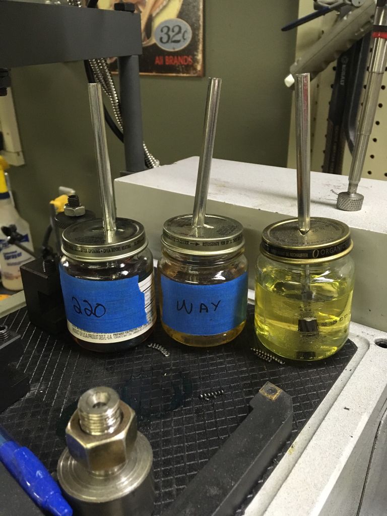

The can on my lathes included cutting oil pump was the only thing that was good about it image.jpgi had a glass jar prior with a piece of steel in the bottom to keep it in place with a magnet but it was shattered so since the magnet was still good i evolved my setup image.jpgnow it is solid and it will not shatter but it has no lid. Somehow, i will survive i am sure.
