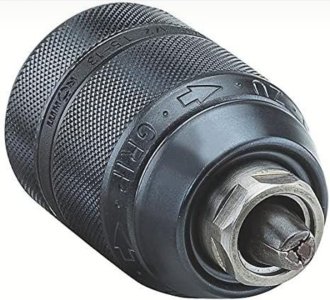

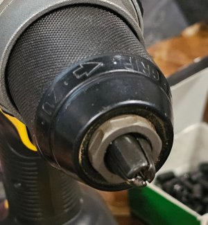

Joni - Can you point me to a power hand drill with a chuck made by Rhom? I'd like to see one. How would I know that one is a Rhom?
This is the chuck on my Dewalt hand drill:
This is a random Rohm I found on the internet.
They sure look VERY similar. Even to where the writing is and the small recess on the Tip.
Edit - I also found this Rohm on the internet. Almost identical to the one on my Dewalt. (which supports what you said about Rohm being the major supplier).
