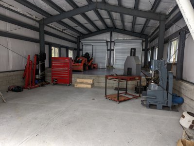

But I will say, having put a pile of stuff in the new shop, I can't believe the difference of "a few of feet, twice" makes on total shop space. My previous spaces have been 18x20 and 16x22. This new one is 24x24, twice (once up, once down, on account of unavoidable grade changes). The extra 6' and 4' each way add so much space. I should have bought a bigger hammer ;-) I do know that when I find the right lathe and mill for here they will fit.
Still a ton of work to get the electric fitted (upgrading the solar on the property), and then I have a lift of sheeting to go up on the walls thoughout.

In a previous life, I owned a similar shop for a rock drilling business (insulated Butler building). We installed 1/2" plywood around the perimeter walls to protect the plastic of the wall insulation. Good idea but not the right thing to do! I hope that the "sheeting" you mentioned above is either fire-rated drywall or better yet steel sheeting. (We just did the lower 10 ft but should have done all interior surfaces. Not sure what new building codes require, our building was 1970s. The soot sticks like a magnet to the nice white plastic - it soon becomes dark & ugly and pretty much not cleanable. Also - at least we painted the plywood a light grey. Painting is easy when the building is empty and it brightens things up and is somewhat resistant to getting dirty)

Can you elaborate on why this was the wrong thing? I'm looking at essentially the same thing - ply up to the lower girt, then drywall above. I like to be able to cleat tools and storage to any wall section.

In the area of your forging/weld splatter etc I would be inclined to 1/2" ply and then go over that with some 1/2" cement board, just for the fire rating issues.
My current shop is 1/2" ply 8' high and then dry wall. Works great. The welding places are drywalled and no wood but that is my garage and not desired really for what I am doing in it - typically I like to move the fire outside

Yes plywood makes a good wall that you can attach things anywhere and is much better than drywall for that. It is also much stronger/tougher and dent resistant. Our shop involved a lot of welding. Plywood is not good around sparks/open flame. You will not likely find a welding shop with plywood on the walls. If you are not welding then ok with plywood. It might just be a question you don’t want to ask your insurance agent.

Yes, I don't do a ton of welding/fabrication, and have the luxury of taking it outside, on the whole.
If you have plywood walls, there is the option of covering the welding area only with an additional layer of drywall....
When I built my garage over 30 years ago I *should have* covered the walls and ceiling in plywood. It would have saved me hundreds of hours of work over the years mounting stuff and adapting cupboards and shelves. I used drywall only, to my regret.
If you do want to get inside out of the wind (MIG or TIG) - suggest you get a couple of portable free standing welding screens to isolate your inside welding area.
