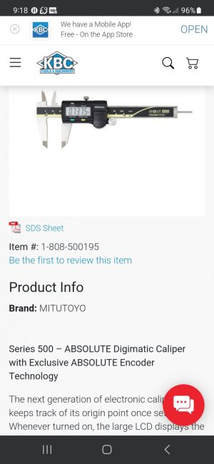

I bought my Mitutoyo in Sept. 2020. I use it every single day, constantly throughout the day. I occasionally forget to turn it off and is left on overnight. It is still on its original battery!!
I am given to understand that the new Mitutoyos are all like that. I have no idea when they fixed it.
I think it was the switch to the "absolute" model that didn't need zeroing every time. I have both models, and bought my Absolute ones in 2007 I think? Can't remember exactly. I got them for $60 Brand new from SB :D. Right place, right time........
