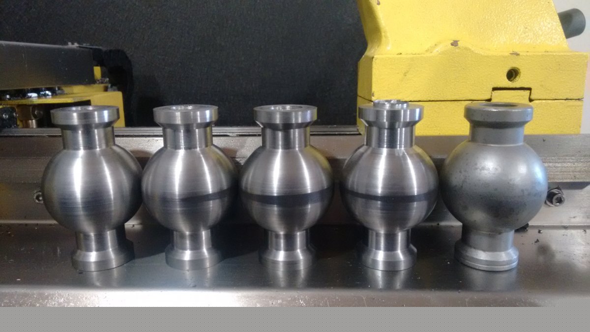

Good questions Peter. Just a disclamer this reply is full of my opinion. There is really no right or wrong way to machine parts and I dont want to knock the way people write programs. I do not and would not recomend using a CAM program and post prosessor for 2 axis turning programs. Take a moment to think about how simple the geometry is on the lathe, you only need to program the simple x and z quardinates and asign a speed during those movements. I have a wonderfull example here.
img_20151025_171324993-jpg.285
These were programed using very simple code and without the use of any complicated g code generating software. Just my opinion but mach 3 is more than powerfull enough for any turning operatons. That being said @Danton has some expertise with fusion360 which is an inexpensive program for generating g code from a solid model. This machine has no noticible lash yet. Taper turning and radius turning is extremely accurate and the repidability is fantastic. To answer your question about meteric or imperial threading. I would say and i am guessing. If running the controller in imperial mode just convert the units to imperial use the same cycle. If you are going to cut lots of meteric threads I recomend running the controler in meteric mode and that will make things much easier.

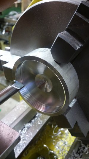

I wanted to upload 1 picture of the cap part to that little container I was turning in the video. Im really enjoying my sunday in the garage.
