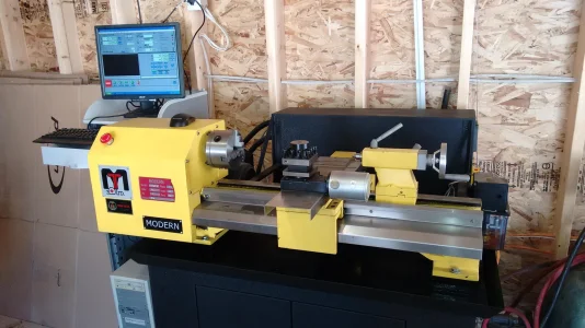

I have owned my hobby CNC lathe for 6 months now. Still no problems with any of the hardware or software. I have learned a few things that didn't come easily. I had to write my own peck drilling macro for G81 because the controller didn't have that built in. I found some info on the internet that really helped make that easy. I even used that macro to drill a 3/16 diameter hole 18" deep. This was just an experiment to see if i could use this machine as a gun drill and I say yes you can if the need arose. Keeping in mind I don't have high pressure oil for guiding gun drills it worked great. I have attached a video with the first half of my current project with some more video that gives you a better idea of the capabilities.

Good questions Peter. Just a disclamer this reply is full of my opinion. There is really no right or wrong way to machine parts and I dont want to knock the way people write programs. I do not and would not recomend using a CAM program and post prosessor for 2 axis turning programs. Take a moment to think about how simple the geometry is on the lathe, you only need to program the simple x and z quardinates and asign a speed during those movements. I have a wonderfull example here.
img_20151025_171324993-jpg.285
These were programed using very simple code and without the use of any complicated g code generating software. Just my opinion but mach 3 is more than powerfull enough for any turning operatons. That being said @Danton has some expertise with fusion360 which is an inexpensive program for generating g code from a solid model. This machine has no noticible lash yet. Taper turning and radius turning is extremely accurate and the repidability is fantastic. To answer your question about meteric or imperial threading. I would say and i am guessing. If running the controller in imperial mode just convert the units to imperial use the same cycle. If you are going to cut lots of meteric threads I recomend running the controler in meteric mode and that will make things much easier.
