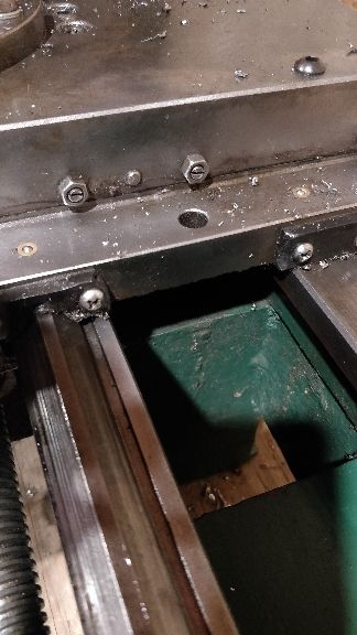

My B2227L is probably third hand and in the few weeks I've had it, I've had the chance to go over it with a fine tooth comb and I've noticed a few strange things. One thing is that it doesn't have a carriage lock. And I've noticed other B2227Ls in YouTube videos seem also to be missing the carriage lock. Did yours come with one? Or is there some reason why people take them off?

@NEKNER, the Craftex B2227L lathe manual in PDF format (open with Adobe Acrobat Reader). Click on Busy Bee's web page
https://www.busybeetools.com/ then scroll down to the bottom (black area third column from left). Click on "Product Manuals" then scroll down to find the B2227L lathe. Then view page 16 which clearly shows , items,13 (Nut), 34 ("T" screw block), and 35 (Break block) which is your basic carriage lock. There's also a spring which pushes the break downward from the ways when released. Viewed from the right side of your carriage (sliding table) it should have a hole centered between the ways, if so that's where the lock fits. I modified my carriage slightly. I changed out the nut (shown sitting on rear way) to a lever which when locked tucks well under the compound slide and when released allows the tail stock to butt up against the carriage if need be. A simple fix that works well.

@Dusty....thanks for the increadibly detailed reply. Great pictures btw! I had found the manual on the Busy Bee website and found a reference to the carriage lock....when I went to find mine all I found are pictured below. Your modification is very well thought out and elegant. I'm going to keep that in mind when I make the pieces I am missing.
