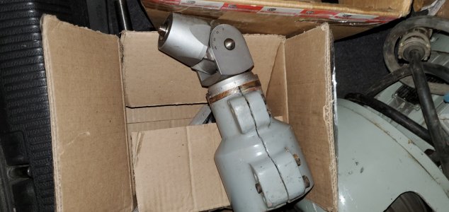

Remember that box, here are the two main items in the box, in addition to the 3 piece right angle head and support bracket.. and in addition to the head, which is a Nantong Bridgeport Clone with an M head. Top speed is ~10K
Spindle is smooth and tight and motor is smooth. I think it will be good for my purposes, but I may just sell it because today I secured a Jackson No. 2 vertical Milling Machine project.

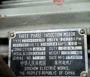

Looking at the motor, it seems to be very serviceable with a VFD attached...
220v 1 HP at 50hz so I'll get 12000 rpm on the high speed running off VFD at 60hz
Hopefully the bearings and balancing are up to your proposed speed.
That's the speed the head was designed for so I'd hope so. But then again, communist chinese product from the 1970s.
That said, this is getting a full tear down and potential rebuild, and it will only ever see sporadic use as a secondary hobby milling machine. I have a better drill for high speed teenie tiny holes so even less demand for the highest speed on this head.
