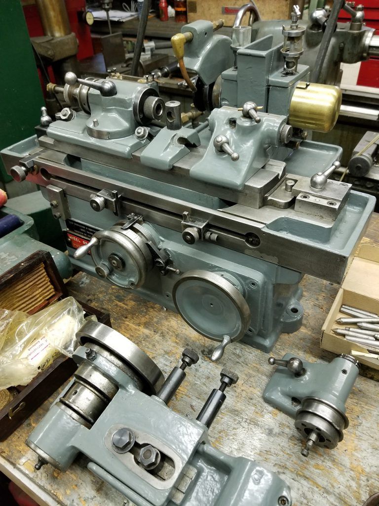

Tom, you're going to love this little guy, a Jones Shipman 520. Fairly rare. I have the regular spindle and the internal spindle. It takes 8mm watchmaker tooling and it came out of the Mercer indicator plant in England. JS was the top the heap for grinders. There is a whole overhead belt system that came with it (not line shaft) that weighs as much as the machine. The Myford grinders come up enough in the GTA, one or two a year on kijiji I'd estimate. Unlike the lathes which were targeted mostly for home use, the grinders were industrial machines and were well regarded, still are.
I already have T&CG - but little cylindrical grinder would be cool. Technically I should be able to use my T&CG to do some cylindrical work but what I am missing is a lot of attachments for T&CG.
What I like here is the size as well - small guy, small foot print.
Besides, I still have empty floor space so I can fill it up with toys.
I paid for my T&CG around $600 on auction about 3 years ago.

Did you mean cutter grinder? Its a cylindrical grinder. That's a much thinner market (imo) among home shop guys than a T&CG (I'd guess that as an older, manual grinder a sale to commercial shop is less likely). Not that it should be, they are extremely useful, but while few will have T&CG, almost none have cylindrical grinders. I've got the baby JS cylindrical grinder above for small stuff and have a T&CG with motorized work head. I use it a lot, but its still not as nice as a real cylindrical grinder.
Its work to a tenth so it has to very precise with low wear and it has to be solid. These are things a T&CG doesn't have to be, or at least to the same extent, to still be very functional (no one grinds an end mill to a tenth over a foot). That makes it a different dynamic than T&CG where one in less than great shape (not saying the OP's isn't, it just look at little tired so you'd expect wear) is still very useful. I did ground up scraping job my T&CG so it would be accurate enough for cylindrical grinding, and it performs, I can grind to a tenth.....but it is light, so you have to hold your tongue just so.
Value will depend a lot on what comes with it, and as you point out, the mechanical integrity. There is special collet adapter for it, they had some accessories including an internal grinding spindle, not sure that tailstock is right....all of that will determine (imo) whether its a lump or something to arrange transportation for 😀
