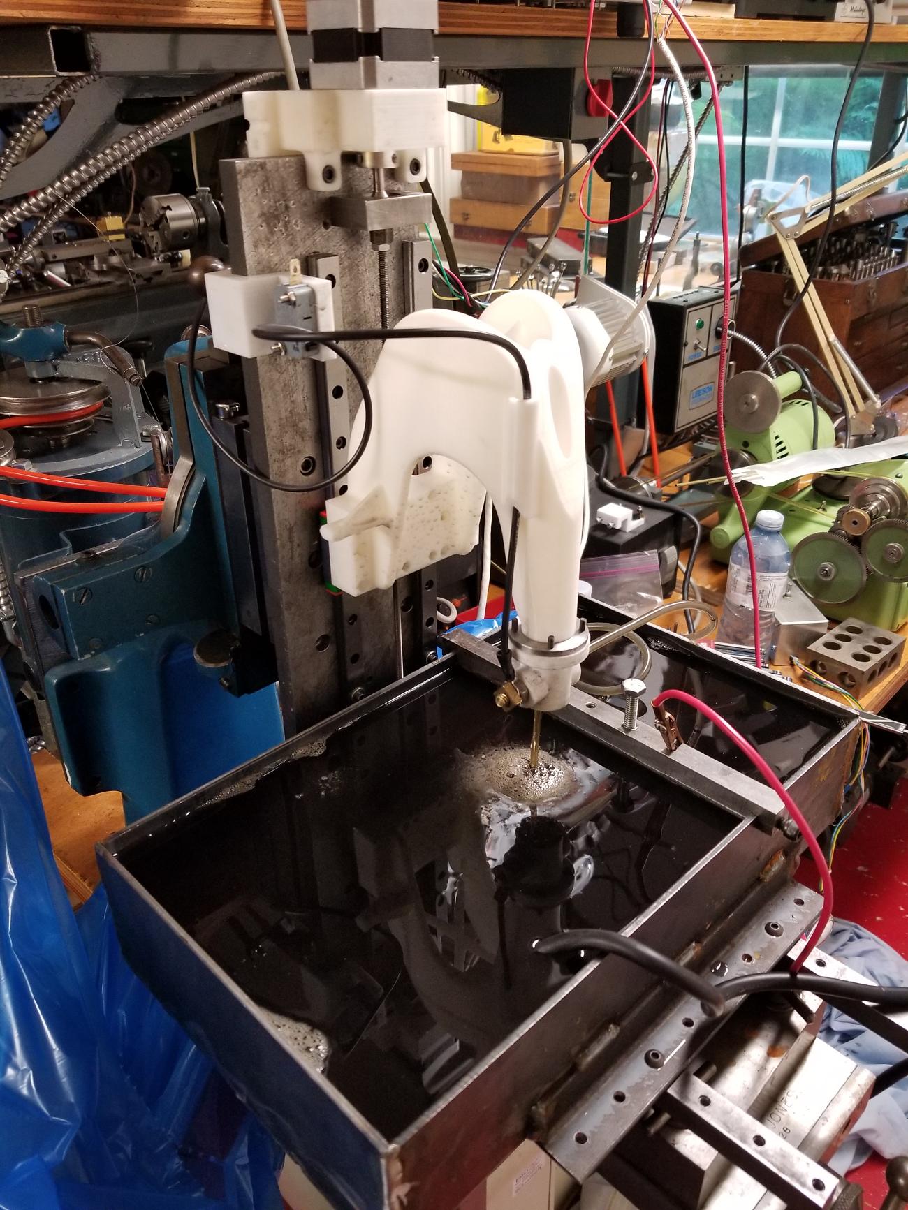

Well, either EDM - which most people have no access to at home & would need to pay $$$
Just make one :D. If you can't touch it with carbide and the part is hard to get/expensive, find a local shop with a sinker....it can be the best way out of a jam

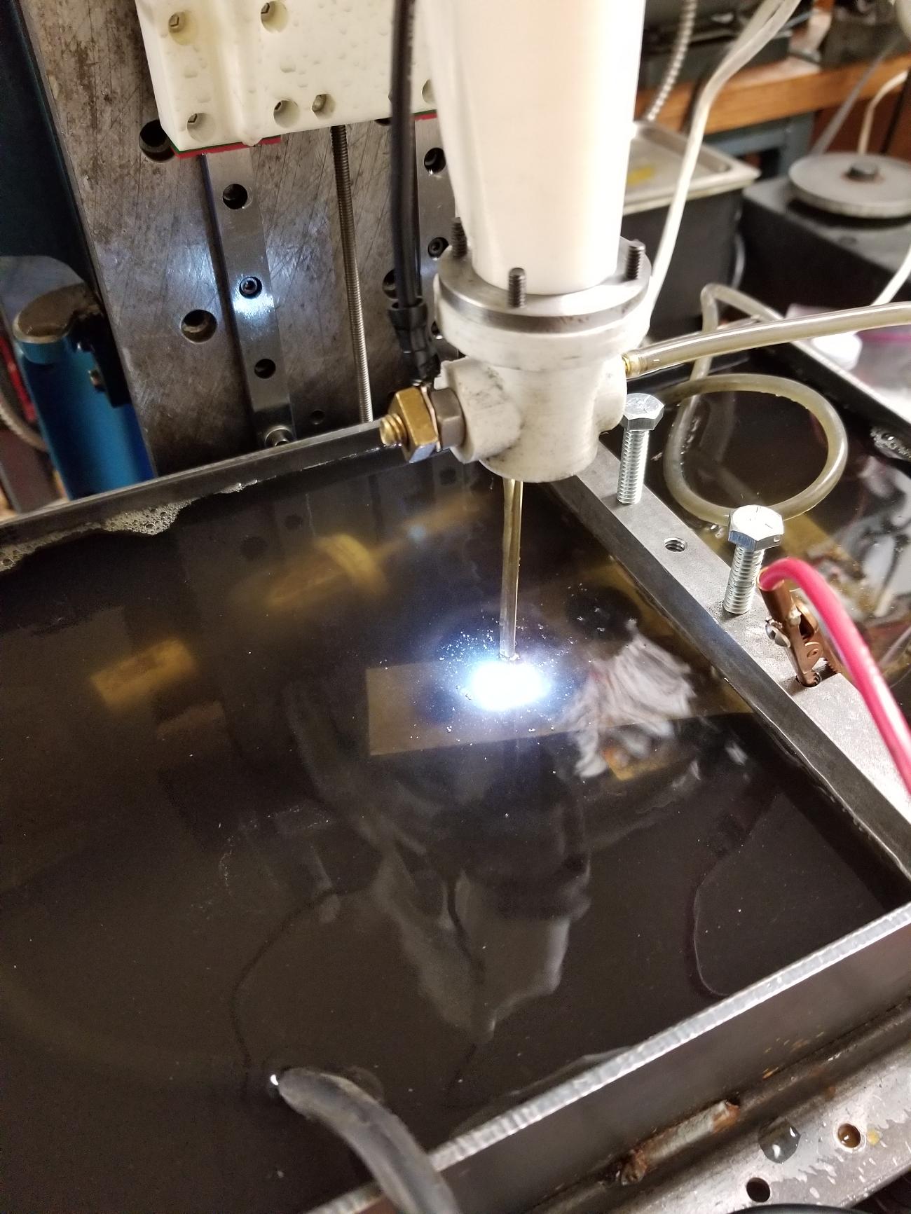

Here's mine in action
I'm confused. Are you suggesting a home made EDM?
No, more just bugging you, saying you should have made an EDM....too bloody late now :). It doesn't get used a lot but its a lifesaver. My real point though was edm is the way to go if its too hard to machine out. I don't know what the replacement part cost is, but if astronomical, I'd phone finding out the price and timing before entirely dismissing EDM. I did qualify that, saying if part is expensive....would make no sense to pay more for EDM than you could buy one for.
I see. I did make a few calls when it first happened. Would have saved me the embarrassment of having to admit on here that I broke an extractor, let alone that I assumed that it was a RH thread when it was actually LH. A lot of personal dumbness exposure could have been avoided if I could have found someone with EDM. Oh well, it's out there now! LOL!

Think about making an EDM some times, there was an article in Home Shop Machinist or its sister mag some years ago. But don't need it till you need it.
