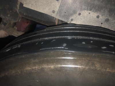

Just out of curiosity, do you have any experience with "river wear" on steers? The inside and outside get bald spots yet the middle stays flat. I can take a pic if that makes no sense
Where the outer ribs wear lower on steer tires? thats kind of normal actually. We see it a lot. If you are talking about cupping, then thats a different story
Thats cupping. Alignment, bushings, kingpins or shocks. Check wheelbase side to side if all else checks out. Could be a misaligned drive(s) too. Something is usually out of whack .

Sorry to tell you Chicken but that steering tire cupping is a bottomless rabbit hole to try to correct. I had 3 trucks, one cupped ferociously, one cupped slightly and on never cupped at all. The really bad one, I tried front wheel alignments, Laser frame straightening, different tire manuf, even those expensive rotating floating ball bearing wheel balancers that are available ( they did improve the ride & eliminated 90% of the truck vibration but tires still cupped). I finally resigned myself to purchasing new steering tires every spring and getting a few more miles out of the "cups" on my trailers.
