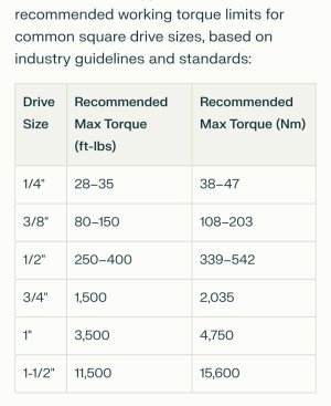

Most 1/2" drive torque wrenches don't go to more than 250 FtLb. You will need a 3/4" drive torque wrench to get 351 FtLb.
A torque multiplier tends to require a bit more rotation of the torque wrench so with the limited space you have to work that could be a problem. If the bolt is loose enough to make a clunking sound you can probably rotate the bolt with a 1/2" drive ratchet. if so the bolt and the shock absorber will likely need to be replaced.
My money is on the anti sway bar links being worn.
Of interest, I found this. It's for the drive system itself and doesn't reflect the maximum torque wrench size.
