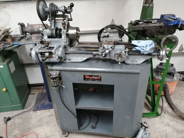

Look what followed me home yesterday. I test this little sucker out and do some fixing. Then either give it to my dad or sell it for lots of $$$ as clearly some pp think they are worth a lot.
Comes with clutch option, 1/2hp motor, tapering attachment, parts of milling attachment, gear box and little bit of tooling.
So far work is needed with electrical, with oiler, with tailstock. Gears that i can see are OK. Bed looks OK. Cannot find serial.
