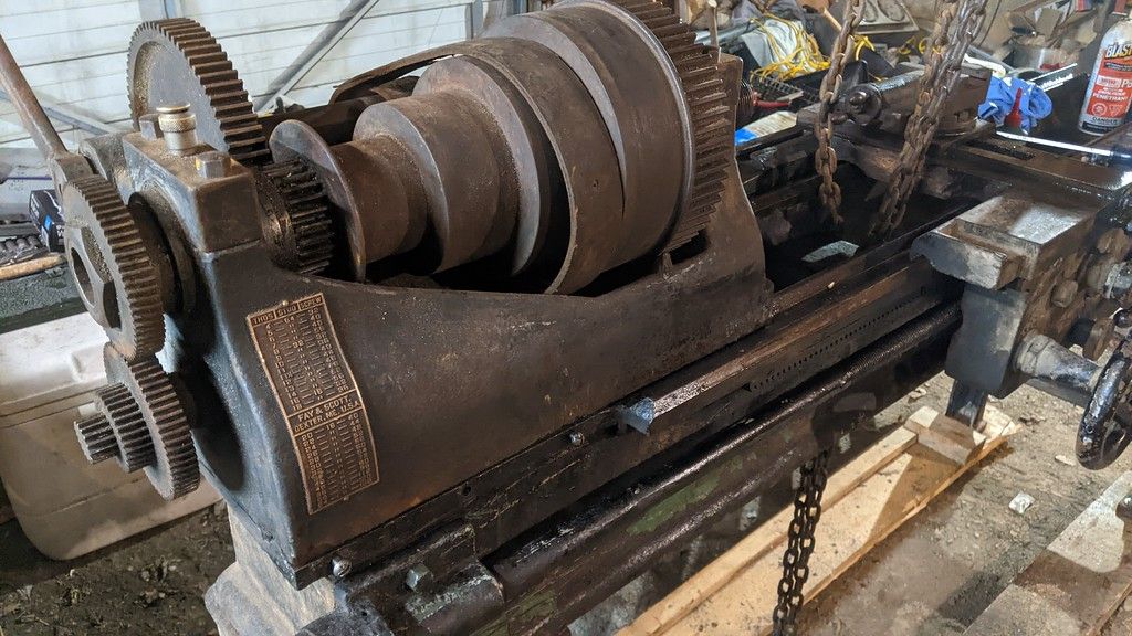

As some of you probably saw in my "introduce yourself" thread, I've acquired a line shaft driven Fay and Scott that looks like it's a 14" x 40" machine. I've got some belting and the jack shaft with hangers. What I also have is a 2HP 120/240v single phase motor that looks to be about 1955 vintage. It works, I've pulled it apart and cleaned the bearings of old sludge, etc. But.... What I'm NOT looking forward to is mounting that up in the rafters to drive the jack shaft. Modern equivalents look to be about 1/2 the size and weight of that behemoth.
My question is, for full capacity on a 14x40 lathe, how much is enough power? I've looked at modern 14x40 machines and they appear to be in the 1.5 - 2 HP range. Now I don't know enough to know if those are horribly under powered or if there is some efficiency magic being done in the modern variable speed controls. Also I'm not sufficiently learned about line shaft setups but I would have to think that there is some power transmission loss in the old leather belts, babbitt bearings in the jack shafts and lathe spindle, etc. Also, and this is showing my ignorance on the topic, are motor ratings on the consumed (electrical) energy or on the delivered (mechanical) energy? Thus would a 60 year old 2HP motor deliver equivalent results to a modern one or would it be horribly inefficient? ?
Someday I've got this crazy idea to hook up a 3 phase motor with a VFD to give "infinite" spindle variability.
Thanks folks
Stew

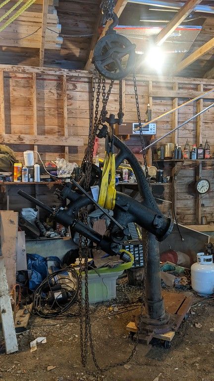

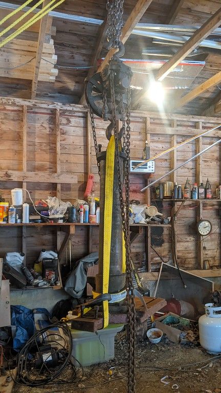

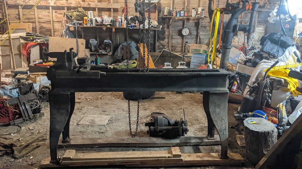

So, as for pictures, here is some of the unloading process.... By the way, excuse the mess, the garage has been a dumping ground since we bought the place 7 years ago and is slowly being put to rights. Want to see us, come any time! Want to see the house/garage/shop? Make an appointment two weeks in advance.... And yes, it's a dirt floor. I've built a leveling wooden platform for the camel back and when I'm happy with it probably fire up the 1950's cement mixer I have and pour a mounting slab for the lathe. At least the dirt doesn't bother my back like standing on concrete does....
Loaded and heading for home.
Unloading.
More unloading.
This was the sketchiest part as it was by my guestimate in the vicinity of 1000 lbs even with the head stock and tail stock removed. No pictures of it suspended in mid air, I lifted it off the bed of the truck, drove out and quickly ran back inside and started lowering it. I didn't want it dangling in mid-air longer than required.
By the way the star of this show was a 1 1/2 ton "screw lift" that my wife picked up for me at one of the online auctions for $10. The big wheel turns a worm which in turn drives a follower which has the chain "wheels" on the side for the lifting. The major problem was dealing with the excess chain since it of course wanted to go down and tangle in the load being lifted...

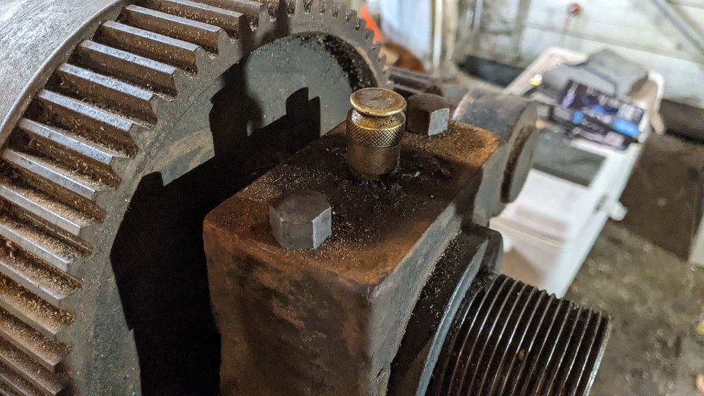

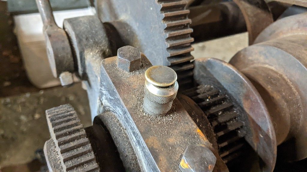

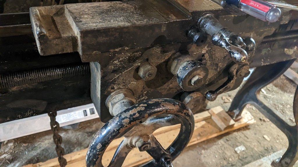

Now for some machine porn!
At some point someone got happy with what looks like a can of stove black and a paint brush. I don't have any plans for a full "restoration" but damn I have got to get that crap off the places it shouldn't be, like filling in the markings on the compound and the handle collars..... It IS marked, just not sure what units yet.

Also, your babbit bearings won't tolerate high rpm's. AIUI, the larger the shaft (and bearing), the higher the speed it will take. There are also different formulations of babbit and some allow a little higher speed than others. If the machine runs too fast, the babbit will just melt and run out! You'll need to choose your pulley ratios with that max speed in mind.

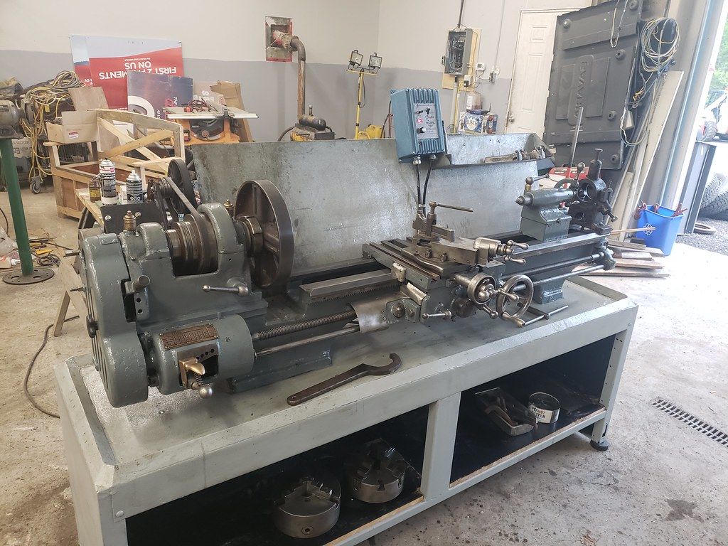

I had an old lathe a while back. I used a 2hp DC motor and variable speed controller, with about a 6:1 ratio if i recall on the belt drive. I should have used 10 or 12:1, but used what i had kicking around. The motor lost power at the low end. I used serpentine style ribbed belts.

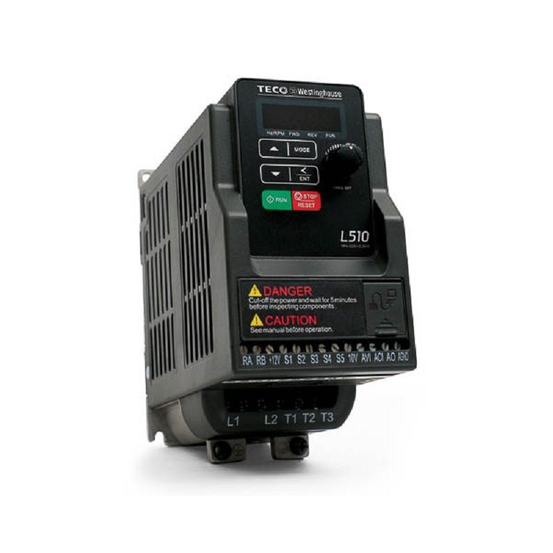

This is one that a few of us are using with great success to do 1PH to 3PH adaption.
Unless I'm missing something, the input is also 3 phase on this particular unit. Mind you if it goes up to 599 Hz then you could theoretically get a lot more speed out of a motor than it's nameplate indicates. ;) That said I'm not sure how things like bearings and armatures would hold up at those speeds.
