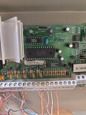

Just got off the phone with our phone service provider. They checked the analog line and verified it is good. I then had them monitor it while I set off the alarm. Sure enough, they could see an "in use" signal during the alarm. I let the alarm continue and they could see a "not active" which means the alarm system is no longer sending the signal.
My theory is that the monitoring centre cannot properly monitor analog signals. Interesting fact is that I was told by two security system reps that they last recieved a signal from our system on June 1st which apparently was "phone line restored". Restored from what? Our phone service provider did not see any issues on June 1st with our landline.
So how does that signal get through via our system (I assume it was sent from our security system) but not the alarm signal?

My DSC system is not as old as that system but has been in service for about 20 years. Is it possible that the outgoing signal is at fault? The security system is interrupting the phone line during an alarm but maybe the signal is in error?
It's annoying when something no longer works but nobody knows why.
I'll bet it's as simple as digital tones vs analog pulses. Many alarm systems include the option to use either one. See if you have the option and then if changing the option fixes it.
100% correct.
I just went through it again. Analog line must have been moved over to phone modem by a previous installer. I just don't remember when this became an issue. I really dropped the ball on this one. Normally, I pay closer attention to these things.

Not there yet. I have a technician coming on Monday morning to verify if the landline is still active. I don't want to remake connections to find out the landline is not active. If there is a problem it may involve going to the panel outside. Finally, I will test the security system before they leave. This will be a free service call since it was their work.
- I dropped the ball by not testing the security system more frequently.
- The alarm company dropped the ball because apparently if the system isn't tested every 30 days they should contact you to make sure all is well (I know, might as well be wishing in one hand and shitting in the other to see which gets filled first). Maybe more modern systems do this automatically, like a self-test or system verification???
- Finally, whomever moved everything over to the phone modem shouldn't have walked away without verifying our alarm system. They should've got us to test it. When I worked on any type of alarm or critical warning system we tested before calling it a day.
