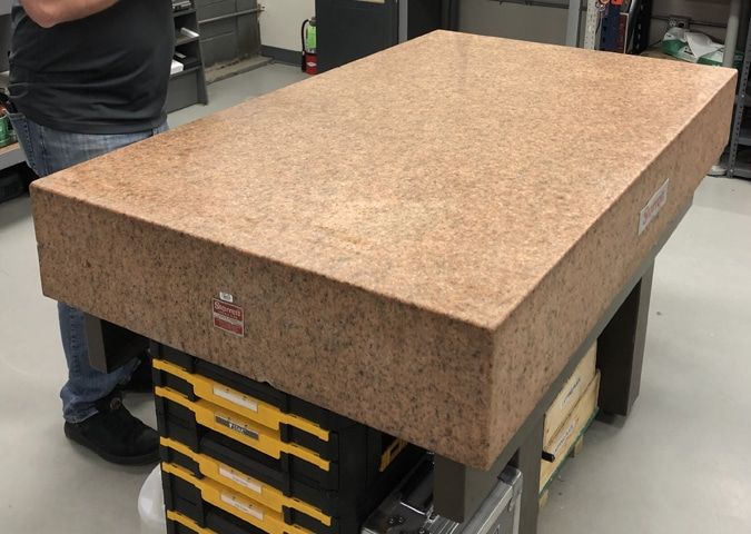

So I dug out my old leaky tube of blue and see that it is also DYKEM brand. Another interesting fact is that it contains paraffin oil.
And brake fluid worked so so for removing it from the hands but carb cleaner worked much better! (I know, I know...)
I cannot imagine what the disrepancy here (over petroleum oil on surface plates) --- Perhaps paraffin oil has some kind of different characteristic than common petroleum oil. Gosh, I've been so careful over the years! But ammonia wipes would make sense now.
Oh ya I also forgot to mention the first ingredient says some like "petroleum" but it is not clear it's definitely petro-something.
What's the problem with oil and surface plates ? Other than the staining? Does it break down the surface over time or something ?
I have no experience with surface plates but I can't imagine the surface could be broken down by any oil. I'd guess the problem with oil is the possibility of it hanging on to grit or dirt?
That's why I was wondering, granite is pretty tough, other than it stains quite easily, just curious as to what the reasoning is behind the no oil thing
What I was warned over 40 years ago was that oil on the surface plate will help "break it down". Tool makers are usually not long on explanations. When I was in their shops learning, I kept everything free of oil and perfectly clean of other debris. To not do what they said was to risk losing shop privileges.
Mitutoyo recommends denatured alcohol (a petroleum product)
Don Baily Suburban Tool recommends a household cleaner (ammonia base) mostly as a cheaper version to Starrett's cleaner. I won't link his video its rather silly
I've seen some other references to ammonia wipes but also a warning that many may also have mild dose of muriatic acid which is a no-no.
Starrett cleaner. A quick look at their SDS... looks petroleum-ish to me
2. Clean the surface plate often & keep it covered. Clean often, and do so with granite surface plate cleaner. The wrong cleaner could leave behind residue that attracts dust, or worse, cause the plate to wear. After cleaning, allow the plate to normalize to ensure accuracy. The appropriate amount of time ranges from 1-5 hours depending on its size.
4. Do not use a water-based cleaner or a volatile solvent to clean the granite surface plate. Both will chill the plate. Volatile solvents could lead to wear, while water-based cleaners will cause the surface plate to retain the water, leading to rust on fasteners and other metal components.
Found a few links about 'blue' removal, but more forum type chit-chat where anything goes: WD-40, MEK...
