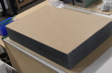

After years of dithering I decided to bite the bullet. Its a 12x18x3" Grade B (overall unilateral flatness tolerance: ±0.0001"). Sourced from Sowa in Edmonton procured through DMH in Calgary.
So the journey begins. I have to make a proper protection lid, for now 1/8" hardboard.

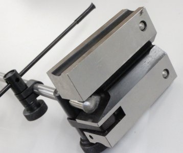

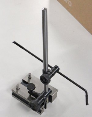

I'm going to start a new post on indicator stand, but just related to above, I pulled out my 'scribey block thingy'. It came from KBC long time ago & has seen little use. It does not have a balled end on the rod accessory like @Mcgyver showed us for square setting. The clamp is not a wonderful fit on the vertical post. I would have to modify or remake it to hold an indicator stem assembly. It does have an integrated fine adjustment pivot. The base underside has 2 flats either side of a notch. Don't know how flat it is yet. I have have seen old school indicator bases which have a pocketed recess on the face so the plate contact is kind of a peripheral ring area. It has 2 vertical dowel pins which must be there for a reason, but its evading me.
Anyway, I'm considering making a surface gage assembly dedicated to dial gage holding. Partly as an exercise in making a nice tool & partly because many of the used offerings on Ebay in my range look like they need work & who knows the history. Haven't decided yet. Likely I could pull a favor & get the base ground, or maybe scrape? I like the looks of Doug Ross design for example. So I'll make a new post when the time comes. Meanwhile if you have seen any plans or desirable features, keep them in mind.
My Browneand Sharp "scribey block thingy" also has those two pins that I've never understood either. When you figure that out let me know too.
Also my version is clearly marked "Not hardened", is there any good reason (other than cost maybe) one would want the base not hardened? Every picture I see of this model on the interweb seems to be 20221117_153010.jpg 20221117_153051.jpg a hardened model.

The pins can be pushed down to use against an edge to scribe a line parallel to the edge.
Hardened or not hardened? The cheaper component is sacrificial. Using a hardened steel surface gauge on a cast iron surface plate risks scratching the surface plate, so gauges are available un-hardened. Better to have wear on a softer $$ surface gauge than on the $$$$ surface plate.

The pins are for riding along an edge. Handy when using a test indicator in the surface gauge, for making sure assemblies are parallel. I use them like that a lot in fixture building.

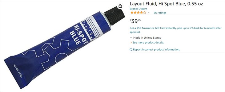

Whats your favorite source for the Permatex blue? I was looking for some a couple years back and found a wide range of prices, mostly either ridiculously expensive or out of stock. Ended up getting Dykem from KBC instead.

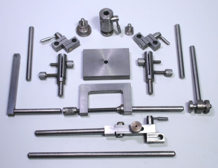

Harold Hall's web site has some ideas for home made indicator accessories:
There is also a Youtube video that gives a short overview of some of the gizmos. For example, the round 'base' in the top-centre of the picture, above, is sized to fit the T-slots of his Myford lathe which makes it useful for tasks like centering stuff in the 4-jaw.
As an aside, after looking at the interchangeable parts that Hall made, it made me realize that the magnetic bases and related arms I've accumulated are a hodgepodge of sizes. Some metric, some imperial and others that aren't a whole number in either measuring system! If I was smart, I'd unload a bunch of them and aim for a set that is 'less diverse'. ;)
(I could swear there was a sketch with suggested dimensions but I can't seem to locate it.)

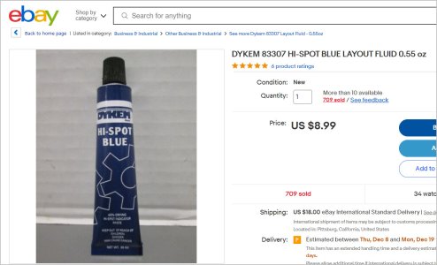

It looks like Dykem (a manufacturer name) also makes a high spot / Prussian blue in addition to layout blue. Maybe that's the confusion.
Yes the Amazon price is one of those berzerk outliers that seems to come up for some strange reason.
I've also heard a certain brands or formulas of high spot blues are more difficult to remove. I'll have to dig mine out & experiment a bit

Since my tube was almost empty I took the plunge and ordered another. Should be here tomorrow. Use this search string at Amazon.ca
Permatex 80038 Prussian Blue.75 fl oz Tube
