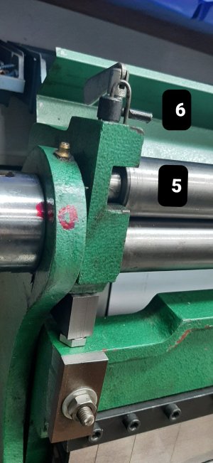

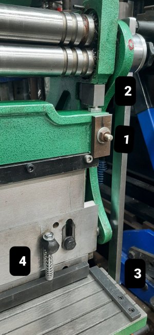

My 3 in 1 metal working machine was not working properly and needed some attention. It's a 40 inch busy bee brand, looks solidly made but poorly put together.
Fixed 6 problems and now it's much better. Fixes matches the numbers in the picture.
1. I made some clamping plate to hold brake beam. Because the pocket were the two SHCS are to large for the heads and don't clamp properly.
2. The brake beam uses two screws to prevent any movement once it's clamp down. Under stress it cracked the thin housing on the geared side. Made some larger block to distribute the pressure more evenly.
3. Made a longer guide to square pieces along the shear. The original guide was 2" the new is 4" long.
4. The clamping bar setup wouldn't clamp anything. Made longer screws and installed heavier springs.
5. The original roller bushing was hand filled round and oval in shape. ???
Made a new one.
6. The removable slip roller lock-in cam screw, which keeps the roller secured in its groove would open under load and the complete roller would pop out. Made a pin to keep the cam lever in lock position during use.
Another thing I did was to machined to the same lenght, all the individual brake plate so that they all were resting equally on the backing plate and the Vee groove.
Finally cleaned, adjusted the shear blade sliders and gap, the brake height and stoppers, greased all the pivot, sliders and gears.
Having worked on some good quality Diacro sheet metal machine. I never really liked this 3 in 1. But after this round of TLC I have warm up to it a bit.

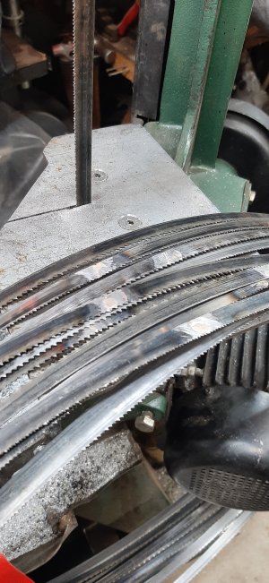

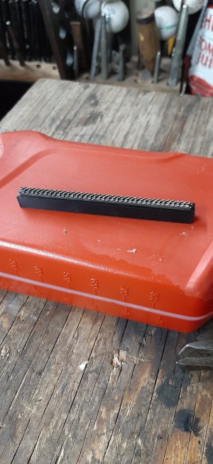

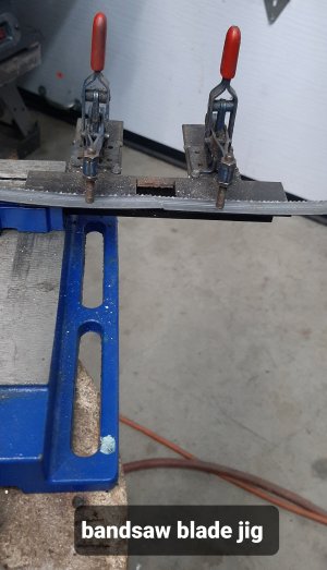

I used up my last bandsaw blade for my Craftex B2442. I had a good stock of longer bandsaw blades ~ 142''. So I cut them to 64 3/4'' which is about the maximum blade lenght my saw can accommodate. At that lenght I might also have a second chance to repair if they were to break. I did a angle split bevel on the ends. The angle was about 20° and the bevel less than 1/8'' wide. Cleaned the ends with acetone and mounted them in the soldering jig, pulling one end out to leave a tiny gap < .003''. Applied flux and a .030'' dia silver solder across the joint and made sure it was longer by 1/16" on both side. Flowed the solder and then removed the excess solder with a file. First time I use a file and found out it gave me a much better control than the belt sander. Made 16 of them, it might be the last time, I will ever make blades again .
I had some small blade left over and thought I would make a back scratcher or a small rasp. I quickly did a print to check blade fitment. Later I will thinker it and come up with a plan to make them. I remember reading about a bandsaw blade scratcher in the Guy Lautard BSM.
