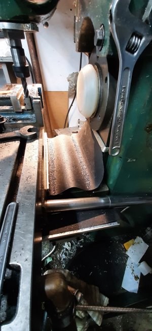

Spruced up the milling machine.
-Replaced the stiff rubber threadmill runner that I used has way cover on my Tom Senior milling machine. Has suggested, I bought drawer liner rubber from Princess A. The material is EDPM rubber, flexible, 1/16" thickness. I can produce a good crease using my 3-1 metal brake ( about the only task it can do well ) .
Its compatible with lots of harsh chemicals but not so well with lubricant and oil. Will see how it does, but no worries its was easy to cut and make one.

I copied the original way cover but made it 1" wider. The hardest part was making the aluminum brackets on the ends. Most of my scraptaluminum, would crack when fully crimped except for a electronics chassis box which was annealed and very malleable.

Frankly, I think it's beautiful. Doesn't trap chips and does the design goal job.
Can I trouble you to take a photo of the saddle all the way in to see how well it folds, and also post a link to the product?

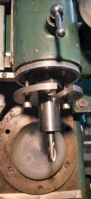

My sticky MT2 milling machine spindle fix. I am getting tired and worried of hammering the draw bar holding my MT2 arbors. Has suggested I tried the dead blow plastic hammer and it didn't make a noticeable difference. So I finally decided to make a tool for the job. Luckily my MT2 spindle is not deep so there is about 3/8" of the taper sticking out and the diameter at that point is about .720". I made this Pac-Man spacer with .750" mouth and two m6 screws to pull the tapered arbor out. It takes so little effort to extract the tapered arbor, I will replace the socket cap screws with knurled thumb screws so that I don't need to find the Allen key to applied the pressure. No more hammering those spindle bearings.
I'd bet your spindle taper is messed up - dirt, swarf, etc. The hammer should work just fine. Won't hurt your bearings unless you are tightening the taper too much. If it takes more than 15 ft pounds, your taper is buggered. 15 ft-lbs should pop loose easy. If the taper doesn't fit right, it's a recipe for bigger problems down the road.
A puller setup is still a good idea though - if you have the patience for it.
Check your taper fit and carefully inspect the spindle bore. It's a lot easier to fix it before it spins than after......
Today I checked my milling machine taper. I can get my small pinky in there most of the way and didn't feel any nicks or burr. I took a fine scotchbrite and held it with a wooden dowel and turn the spindle power on. Raise and lowered the scotchbrite dowel a few times and then clean the taper with a paper towel. Gently inserted, no slamming, a MT2 arbor by hand and it was a little difficult pulling it out, compared to the gentle insertion. I think my taper is fine. I have hammered the draw bar on the Bridgeport R8 taper at work for many years and never had an issue. I am just a wimp when it comes to hammer on a bearing assembly.

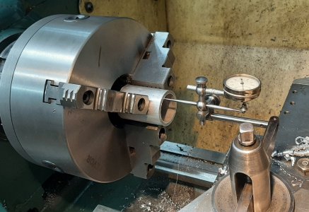

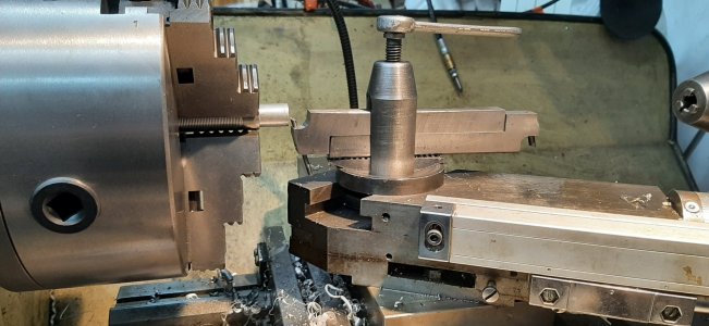

I got some 1/8" and 3/16" round carbide blanks in a lot I bought. I made a tangential holder for each. When in use I stack them one on top of the other to fill the void in my lantern tool post. They are now my go to tool for turning hard materials.
I wish I had seen that setup of yours 40 years ago when I got my old lathe. Of course I didn't belong to a forum like this to share ideas on back then.
That's a great setup. You could do sonething that with HSS too.

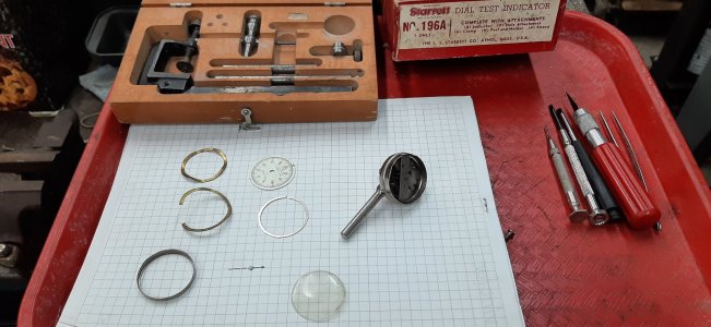

Restored a Starrett 196A back plunger dial indicator. .001" / div , .200" travel and a bonus 1.750" indicator lever reach. The whole kit was completely corroded with this white powdered oxide. The oxide grew between the gaps of every parts and the dial movement seized. Surprisingly it came apart without to much effort. Corroded but not locked together. Soaked all the parts in varsol with the ultrasonic bath turn on for 20 minutes. Did some stoning, filling, scotchbrite, polishing, cleaning, rince and lube until everything was fitting smoothly. I made a flat mylar lense it just touches the indicator needle but doesn't affect it.
It can be a useful dial indicator if you need to reach deep inside a small hole. Attached to a 123 block it can also be use on an inspection table to check if parts are square.
But a little finicky to set up the swivel arm, plunger and the linkage.
