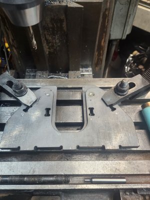

Typically what happens around here with a project is they get stalled on some aspect (material, tools, talent....), put aside, and "acclimatize". This one got stalled on the fact that I needed some 1.5" Dia rollers. I didn't have any 1.5" stock, and the thought of turning down my only 2" stock which was either some 17-4, or 4140 didn't really seem like A) a good time, or B) a worthy use of that material for this project C) I had it earmarked for something else......This project not really being a high priority thing that needed finishing, I tucked it out of the way (after moving it a couple times....) and waited until I might stumble into some suitable material, or needed to make a trip to the metal store for something else. Fast forward a couple months to Monday night when during my habitual marketplace browsing I stumbled on an ad for some 1.5" bar, a 3/4" bar, and some 1/8" plate for $20. The kicker, it was literally right down the road, and posted by an old acquaintance. After a good visit of catching up last night while picking it up, I bumped this project back up the list to finish it off.
The haul
I took the two side plates and lined up the bottoms and on of the tabs with some setup blocks, then tack them together.
Then clamped them down to the mill table on some parallels, edge found the bottom, and middle of the slot and then proceeded to drill and ream them to 0.501" based on the locations from the design.
I ground the tacks holding them together off, and Next was to cut some 1/2" pins, and fit it all together with some 123 blocks to keep it square. The pins fit perfectly with a nice slip fit. Lets hope they stay that way after welding......
I tacked it all together, removed the clamps and 123 blocks, then welded all the tabs up. When I designed this, I left the tab ends short 1/16", hoping the plug weld would fill the gap, and I could grind it flat for a nice finish. If I were to do this again, I would only leave 1/32. I could go back and fill them up a bit more with weld, but I'm not bothered that much by it. For my first tab and slot design, it's a learning point (there's been a few so far...). I also didn't want to weld too much to fill them up for fear of twisting it all up like a pretzel. After all was said and done, the pins fit perfectly, and the base was still nice and flat. It didn't twist at all. I like this method of design.....will use again in the future.

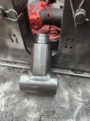

A few ways I could have done the ram, but decided to just stick with the same material, and notch the ram mount it to make a weldment. Was all set to cut the fillet radius with the boring head, then had an idea to try an annular cutter. Just so happened to have an 1.5" one, and it worked great. Took it in a couple bites, but zero issues. Much quicker than a boring head would have been.
Nice fit up
All welded up
And here it is on the press, ready for work.
The more I look at those slots, the more they bug me......I will fix them tomorrow, and head into town for some paint.
I would give my left Tstcl to weld like that....... BEAUTIFUL DAN!
Thank you, I was actually shaking doing that because I was holding the part by the ground clamp clamped to the pin end, and welded that in free air. First bead went great (rh side) the 2nd (lh side), 3rd (back) and 4th (front) were all pretty shaky. I was trying to counteract one hank shaking holding the part, with the other hand shaking doing the welding , but I had just getitdoneitis pretty good at that point......The trick is just to shake consistently.....:D
