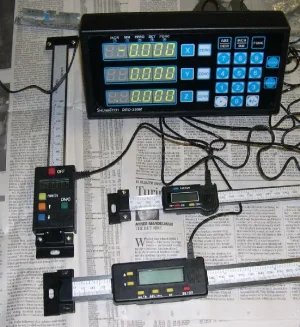

Mine does things like bolt circles but I have to pull out the manual each time to figure out how to use it.
Connects to the cheap (likely no longer available) Chinese scales. Also works with a probe (and probe diameter) to find the center of a hole.

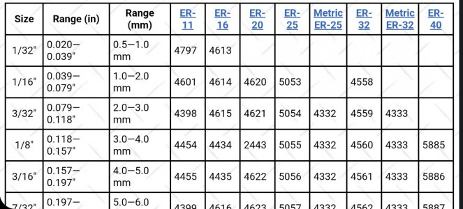

Here is a sample chart from Little Machine Shop.
Here is a link if you want more detail.
Notice that a 3/16 collet is also listed as a 4 to 5 mm collet. This is true through the full range.
Other web sites don't necessarily list them this way. Most list a set of separate metric collets or an imperial set. I cannot find such as set that provides actual dimensional information to prove that they are really either metric or imperial.
This leaves a rather difficult set of alternatives. Either both are actually the same just different labels, or they are physically different with different dimensions.

IMP & MET collets are not the same. I think this is a case where LMS is trying to be helpful by converting, unfortunately is causing potential confusion as it pertains to physical sizing. They do that elsewhere on the site, maybe its hole/thread sizing I cant recall. Anyways you don't want to stretch collets above nominal even if it appears dimensionally close. And collets do have a recommended squeeze range (diameter reduction) but that varies by collet type. The ramifications are worth considering. Distorting (ruining) a collet is one thing. Having it come lose when you thought it was tight can pooch up some milling work you may have invested time & cost.

For example, I looked a little closer at the little machine shop collets. Contrary to my first assumption, it turns out that they are actually metric with Imperial markings. Not imperial with metric. Go figure!

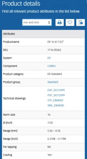

A more reputable source of info, Haimer. They list metric and imperial collets. If you do the conversion, a 2-3mm collet has a max opening of 3mm or 0.118" , a 1/8" collet has a max opening of .125". A 3-4mm collet would have a max opening of .157" so a 3mm shank would fit but again, not optimal. Within the ranges as presented on LMS their reco works, but not best practice for holding power. Advice found elsewhere "Choosing a collet that exactly matches the cutting tool diameter improves grip force, accuracy, and rigidity, resulting in extended tool life and better surface finishes."

I also dove a bit deeper into the LMS chart and I believe you are correct. They are just trying to be helpful. Basically, they are saying that you can use a 6-7mm collet to hold a nominal 1/4" shaft. If they had put metric first in their chart and then titled the imperial column as "Also fits Imperial" and moved that column further right without the bolding, it would have been ok. Especially since that is almost exactly what I was trying to accomplish in the first place! I was trying to find a better fitting collet for a 17/64 drill. As you all know, collets don't expand. So a 17/64 drill requires a 5/16 collet and won't fit a 1/4" collet. But, tightening a 5/16 collet down to 17/64 hurt my sensibilities - WAY TOO MUCH tightening. A 7mm collet would have been better. Hence my over thought journey.

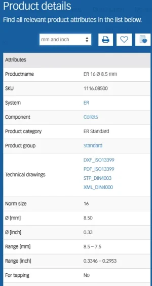

The Rego info is quite clear to me :-) Is it becasue I am born in EU? Not sure.
This screen shot shows the entry for an 8.5mm ER16 collet. Normal size is 8.5mm/0.33" and it has a range, metric and imp. But the nominal size is 8.5mm regarldess of what else you can fit in it. The best grip will be on that nominal size, anything else will be less. That is the whole point of using nominal sizes, just like with 5C collets (which have almost no gripping range outside the nominal). The same info for a 7/32" collet shows it is nominal 7/32, with a metric equivalent shown.
