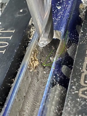

I was milling out a slot in some stainless steel with a .250 carbide end mill. It was going smoothly I thought...but I backed out to make the slot a bit wider and it snapped the end mill. I was milling dry and although I was going slow it was getting hot and it appears some swarf is welded to the sides see picture.
I dont want to remove the piece from the setup and am hoping to be able to use the broken end mill to continue to widen the slot by .062" on both sides. I have the length needed I just need to make the slot wider now. ⁰ 20210115_135132.jpg 20210115_140129.jpg

How much did you have sticking out? Do you have a rigid set up? At the time the end mill broke were you climb milling or conventional milling? Swarf and re-cut can give you major problems (the #1 reason for flood coolant is to move the chips away) - I assume you can't use flood coolant so an air blast is a reasonable alternative. Cut the end mill off and carry on.

I had quite a bit sticking out and think I could have done better there. Yes fairly rigid setup and taking pretty light cut. I call what I was doing a conventional cut not climb milling but I'm not sure that is quite the right term as the cutter was cutting on 3 sides of the mill. I plunged the cutter in and then moved y axis the length of the slot.

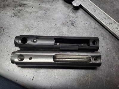

I've got more milling on the other side to do....the brown piece is the original plastic piece and im making the replacement out of stainless steel. Picture shows top and bottom of the pieces.

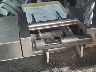

I dont have a v groove block thingy to clamp this piece in....this is the only way I can think of holding the piece to mill the remaining flat spots. ....I dont think this clamping method is legit?
I need to use the milled flat spot on the bottom of the piece as the reference to get things straight. 20210115_152044.jpg 20210115_151435.jpg
I suppose I could turn the piece on it side in the vice and mill the end flat spot successfully but the middle channel has got me baffled.

What was the cutter rpm. You should be using coolant especially with stainless. Try plunging the slot at .020" at a time full depth (with a new cutter). Should be running at a minimum of 500 rpm. Then come back and run the cutter at the same x,y settings followed by widening the slot in .010" increments. When you widen the slot, both at the beginning and end plunge the slot. When you do the spring cut, you won't need to plunge.

Rmp was 1200. No coolant. I'll try to figure something out.
Tom Kitta
for 1/4 carbide RPM was low. I usually run 1/2 at around 1200 rpm in stainless. For 1/4 try at least 2000. This is actually considered slow even for dry.
Your endmill looks like its a 2 flute for aluminum - it is definitely not for SS. Uncoated carbide 2 flute == AFAIK aluminum. Can use on steel in "emergency" but from experience I can tell they do not last long at all.
Breaking endmill like this usually is due to some sudden high load - as in your endmill caught something or something moved. Most people are not running their endmills hard. Running "hard" is possible with tiny endmills even when careful - like 1/8.

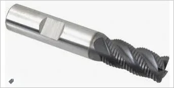

This might be a good application of a finer tooth roughing end mill to first make the center slot in consecutive passes & save your carbide EM for edge finishing the slot sides once the material is hogged out. I've always found roughers cut efficiently, make less vibration & better chips, especially tougher materials. They just seem easier on everything especially when you don't have many great clamping setup options, which you don't. The milled flats should be fine with the carbide.

Generally I like to use Vee blocks on round things with biggish removal features if possible. Again your part may not lend itself to vee blocks because you are flipping to different orientations that have to be square or perpendicular to one another. But the principle is Vee blocks provide 4 lines of contact, vise jaws only 2, mill table & clamp kind of 1.5 depending on the strap. Arguably the vee block contact lines are shorter than vise jaw span but typically vise jaws provide a bit of top squeeze which means lateral plus a bit of downward clamping goes through the vee face to the round part. And this may save resting the round part on a parallel or partial parallel.

I do have a roughing mill but wasn't sure about using it or not.....my inexperience.
I plunge cut a hole to the center bore and then traversed up the length of the cut and all was good. It was when backed out just a wee bit then the EM snapped. I suspect that it was as suggested,the backlash of the table and the fact there was welded swarf on the side that the now climb milling operation was too much for the long end mill.
Yes I had the y and z axis locked. No coolant and apparently running too slow rpm and more stick out of EM then was necessary. I'm learning....always the hard way.

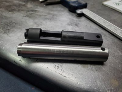

Well I got er done..well a couple of small things to do but the machining is done. I'm happy with how it turned out. . As with most of my projects, I learned as I went, it took far longer than what the project is worth but it was time enjoyed!
It is a breech/receiver for a cheap pellet pistol that isn't worth the work it took to make this but that was beside the point. 20210116_170905.jpg
Looks good. Ya now that I see the proportions better, there is no way you could bore the hole as a second operation without creating a different flavor of grief.

I haven't a clue what alloy of ss it is. It was a small chunk I had on hand that was given to me. Its totally non magnetic ( not all ss is non magnetic) . I was going to make it out of brass because it is so nice to work with but I think the stainless steel looks great and doesn't dull like brass ( either material is overkill for this particular project but it was a fun thing)
