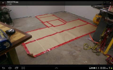

I also cleared out the corner and placed the template down it looks like a 45 angle to the corner will be the best choice when the mill gets here.

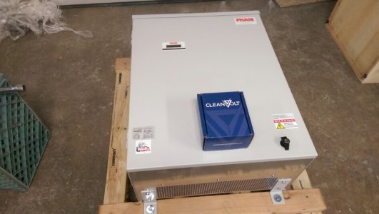

We got back some floor space today by building a stand for the soft jaws now we can start mounting the converter and plan out what we need before getting the electrican in.

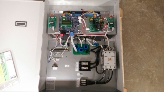

The push has slowed down a bit we hung the converter on some 1" chipboard left over from the shed flooring and I am running the wires to it, the electrician will come over Sunday to do the connections and wire in the surge protector. The converter has no knockouts which I thought was odd just a piece of paper telling you to clean up all chips!
Today we finished up the wiring exept for the end when the transformer gets placed tomorow and powered up there we will bring it across and down.

The electrician came today and hooked up the lathe and surge protector it fired up ok and the spindle turns and all axis move then we got a low oil light so we'll have to get that topped up, the m button needs a fairly hard push though but we have another controller if it doesn't loosen up any.
The sparky left and we put the cover onto the transformer and Adrian was taking off he said I"ll show you how to fire it up in case you want to play with it,... and it doesn't boot up....... after a headscratch we pulled the cover off again when we put it on we doubled over the unused wires and wrapped them with tape we didn't realize that one of the 120 feeds pulled out and we taped that too! Back to a happy camper!

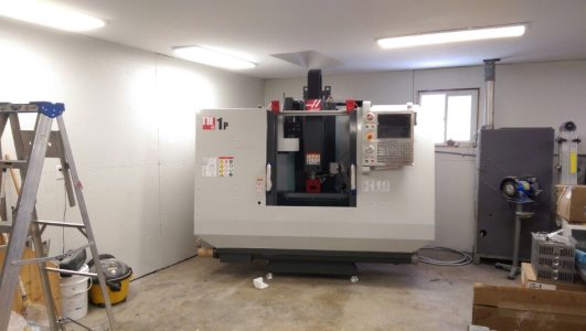

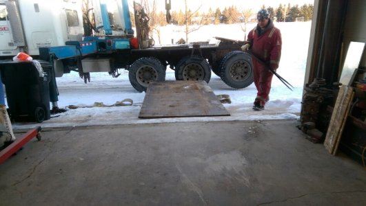

The mill came today at 8:30 am and was in place by 12:30 after they removed the feet and top components so no more worries about getting it through the garage door!
They used a 1" plate to roll it into the garage it also had to be turned a bit more to fit the recess in the ceiling

Your welcome! It still needs trays and electrical hooked up the sparky pulled a noshow Sunday theres a lots of boxes and grease to clean too!
We put the trays on yesterday looks much better.

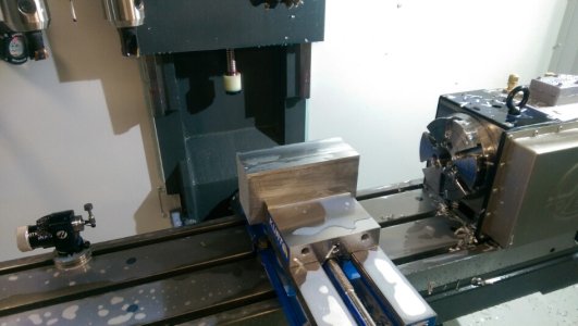

The wooden box contains the 4th axis and the box is the 3 jaw chuck theres a tailstock around somewhere too.
One problem we have is the 3/4 "collet they sent us a 19 mm indexable cutter that won't slide into it!
19 mm = 0.7480314961 so it should fit I'm a little hesitant to emery the finish off the cutter!

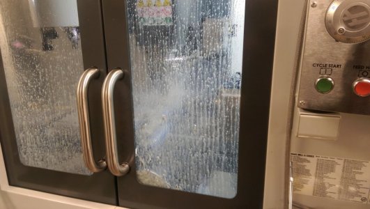

In the meantime we have beem getting use to the probing system and have faced off 4 sides of a block checking out the code that was produced and machining at 5% watching (or trying to) for that WTF moment so pocket and contours next. We also still have to mount the chuck in the 4th axis.
Trying to watch!
