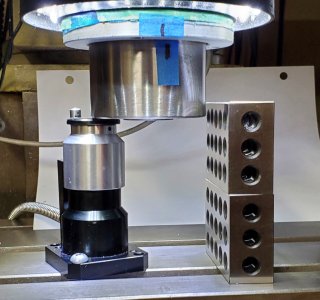

Here's my approach to determining the tool setter trip location.
1. Home system
2. Move up to the stacked pair of 1-2-3 blocks set for 4". Use MPG to sneak up until blocks no longer slide under spindle face. Note machine co-ordinate Z value. (-8.701 in one trial)
3. Now issue the following G-Codes
a) G91 for relative rather than absolute
b) G38.3 Z-1.0 F2.5 which moves down at 2.5 ipm and stops when tool setter triggers
c) note machine co-ordinates Z value (-9.0423)
d) G90 don't forget to go back to absolute values.
Now the math. The Block value -8.701 minus the 1-2-3 blocks (4") results in -12.701 which is spindle quill distance to table at home position.
Next subtract the Tool Setter trip point from that spindle quill distance. (-3.6587). The positive value is the tool setter height.
Now put in a TTS tool and once again position over the tool setter. Bring it close and then use the same procedure as step 3 above. Except now the value will be less negative.
Same math as before. -12.701 - tool setter height(-3.6587) - the tool setter reading(-6.2968) = 2.7455 rounded up is abs(-2.75)"
That value is entered into the tool table and used by the system to offset from the current G54.Z value.
