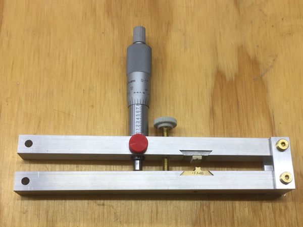

Some rodmakers have "designed" a poor boy version of this which uses the Sunnen guide shoe and stones. This might be the way to go. I have a couple spare micrometer heads that you can have if you decide to go that way. See below..
VERY interesting thanks for link. The mic head would certainly provide some dimensional feedback I'm missing with my methods.
