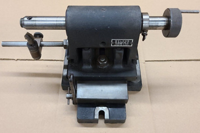

Weldon makes a endmill sharping fixture for surface grinder but probly could be set up for use with dremel or bench grinder. There not overly expensive I bought one bit ago but haven't used it yet.
Looks very interesting. The real deals are too much money for how often I'd use it. This one is still way too much coin. But at least I can see the makings of a home made unit that could do the basics.
But first I have to learn to sharpen drill bits......

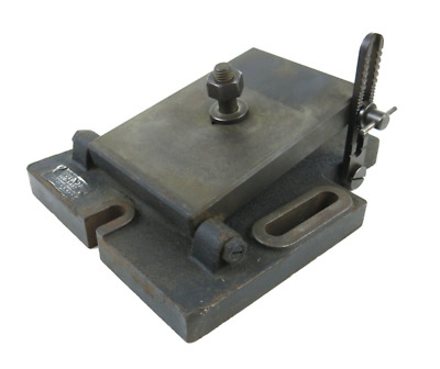

I have the top part of that but no collets or base. Looking at that base I’m not sure how it’s adjusted.
I would think it would need a fine feed but I can’t see one on the eBay one.
Neat didn't know there was sine plate for that, mine is bit different model then the one shown. But they both use the air spindle so maybe the sine plate is universal?
