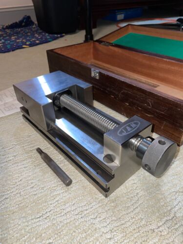

This vise caught my eye the other day:
I asked about shipping, they agreed to ship it to my address in the US, so we made a deal today and it's on its way to me. Its 120mm wide by 150mm opening. Retail price is around $3000.00 USD so $400 shipped is pretty decent :D

Good stuff Jeff......these are where the micrometer stand becomes a necessity!
